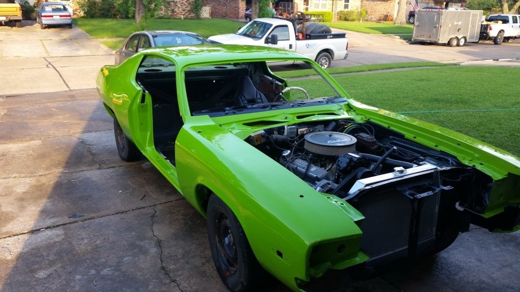

1973 Plymouth Satellite can I do this wheel and tire combo without any modifications and no rubbing or sticking out of the tires.
15X8 with 4.5" backspacing with 235/60/15 on front
15X8 with 4.5" backspacing with 275/60/15 on back
And I really do not understand the "offset" measurement listed on some?
I keep getting different info from different vendors so I am coming to the experts. I would like to purchase this week. Any help is appreciated.

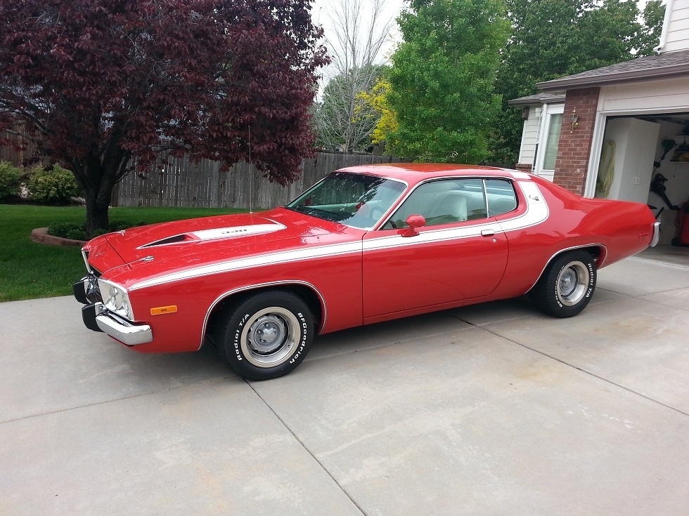

That is the exact setup I have on my 73 roadrunner with Rallye wheels no issues.

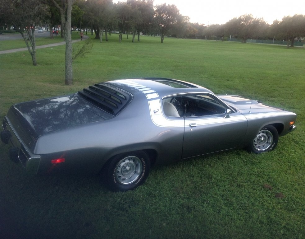

I've had 265 50 15 on 15x7 Keystones on the rear of mine with no issues and room to go wider.
Not sure of BS, though.

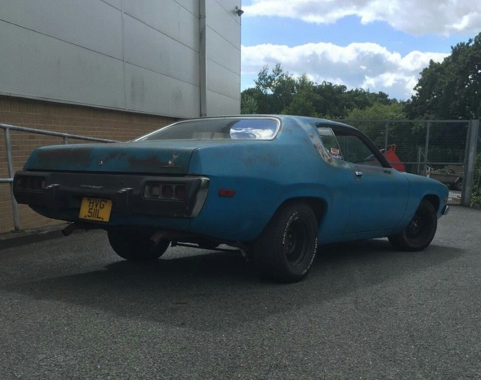

Yes, it's a bit of a junkyard dog looking, although very solid throughout. Built 340 and 727, big front brakes
Wheels are 8 x 15 and 7 x 15 front tyres are 235 section.

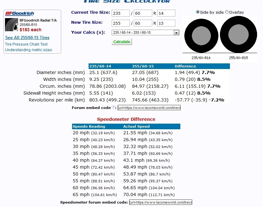

Thanks to this thread I pulled the trigger on 255/60/15 Cooper Cobra RWL for the rear of mine.
I already have a pair of matching 235/60/14 that I got to test on my 14x6 Spyders.
They're going on period Keystone Klassic wheels with the optional gold painted centers (versus black, and not to be confused with the special edition gold wheels)
So don't forget to adjust your speedo gear and/or make sure you have the correct one installed for the new wheel height.
