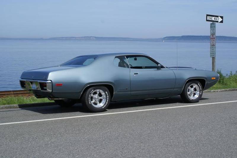

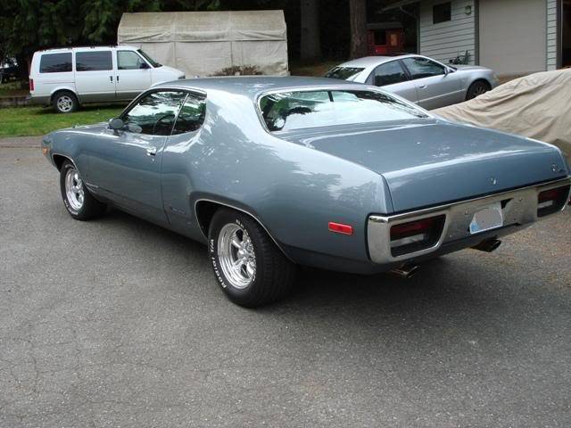

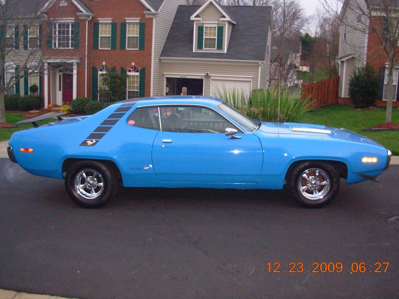

ok here's the results, these are ION Alloy 625 series wheels, 4.25" backspacing, -5 offset 15x8 on the rear with 275/60-15 Big O - Front has 15x7 3.75" bs -6 offset 255/60-15, I also put new Gabriel Air shocks. Clears fine, a little lip grind on the passenger side to be sure though. 4.5 BS would have been perfect.
Nothing ... and I mean nothing looks better on a 71 or 72 Road Runner than Petty Blue. Nice car.
The Winchester Grey is very, very nice ! and a rare color too, and I really like that, .....but there are just some body styles that just look better in certain colors, I like the Petty Blue on 72 runners, I had one that color so I guess I'm a little partial to it, the whole color thing is strictly a matter of opinion and we all know what opinions are like.
I like that grey a lot, I don't think I've ever seen it before. I love the unique colors, the ones you don't see often. Like the Petty Blue, Sublime, Grey, Dark green.
When I went searching for a runner I looked for Sublime, smartly several good folks saved me from a mistake and I came upon the Petty Blue car, I honestly couldn't be happier.
Thanks for the compliments, I appreciate that very much

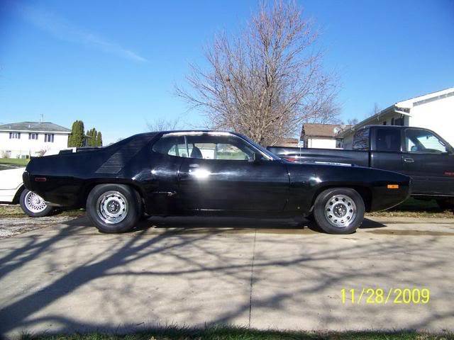

I have a 73 RR that has 275 60 15's on back and F70's (i think) on bias tires up front.
I know that the ones up front need to go!
What's a good set up on these 73 B bodies? I like the 295 50 15 because they're wider and sure fill in the wheel wells but I'm also looking at traction. I have SS leaf springs on the back so the car sits high, I've heard that they're great springs for traction along with a snubber, I've got 3.54's w/489 in the back but not sure grip (looking for) so a smaller tire diam (26.7 for 295's would help bump up the gear ratio a bit and although they're a little wider there's less of a tire print correct? Which tire would give you the most traction a 275/60/15 or 295/50/15 or am I splitting hairs? It looks like the 295's would have no problem fitting in the back correct??
