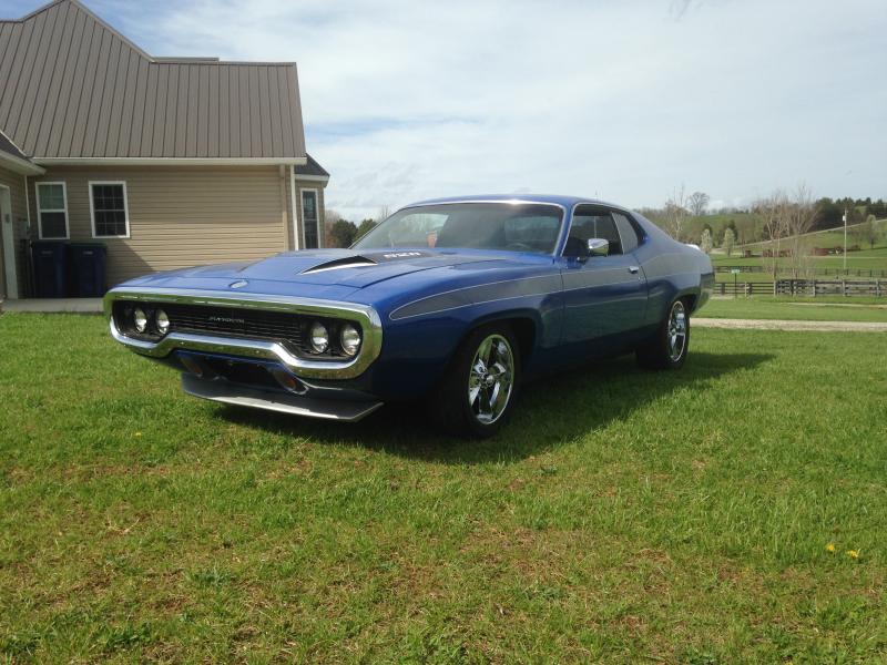

Would like to get some input from you 71 and 72 Satellite owners as to a nice wide and tall 17" or 18" wheel/tire setup on the rear and a somewhat smaller and shorter 17" or 18" wheel/tire combination on the front. Don't have a lot of ground clearence in the front due to 8 quart oil pan and headers. Don't want the rake to be too great but noticable. Very concerned on wheel backspacing as I don't want anything extremely tight. Running 3.91 rear so taller tires will not harm performance. Would be especially interested to hear from those that are actually running a combination that I'm trying to define.
Thanking you in advance

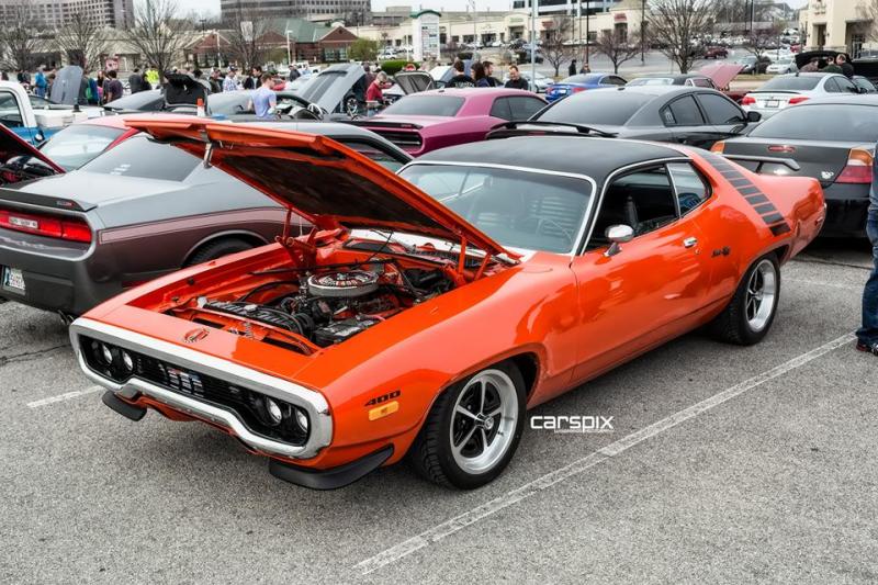

I have 17 inch Magnum 500's on m 72 SSP. 17x8 4.5 backspace for front wheels with 245 17's.
For the rears I have 17x9 5.25 backspace and tire size is 255/50/17's. Hope that helps a little. I could go a little wider tire on back. All suspension is bone stock.

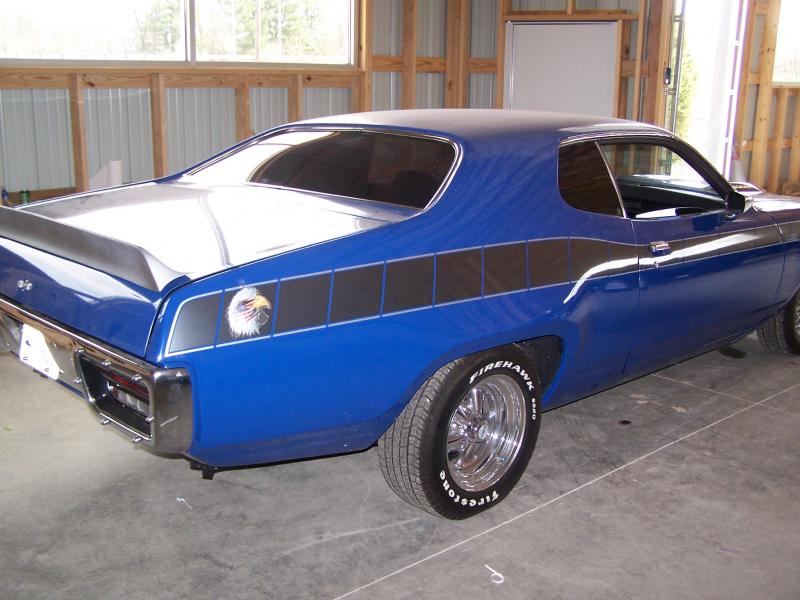

Does this help

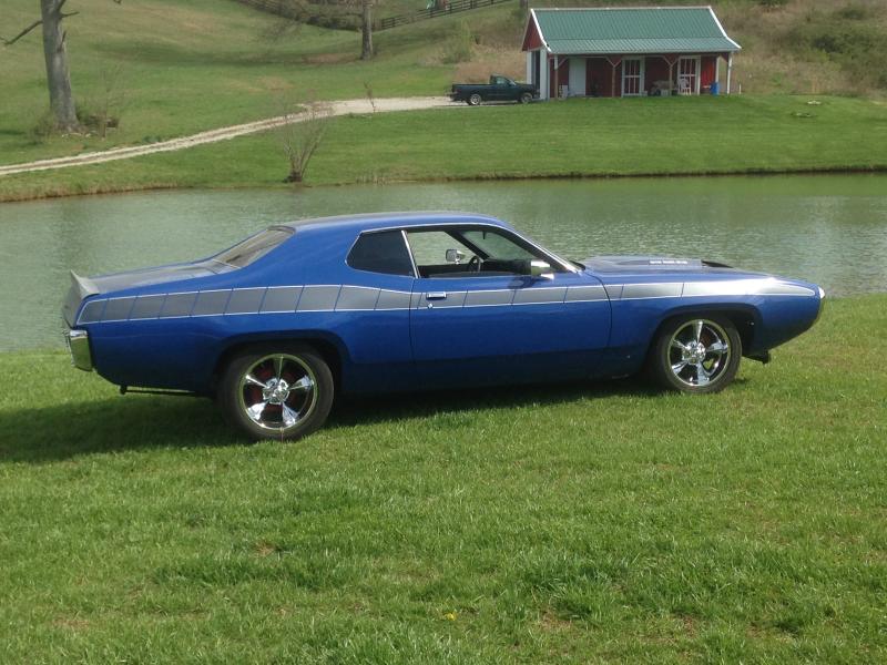

I just replaced the 17" Torque Thrust 2's I had with these wider 17" Cragar SS's. My specs probably won't help you since I was going for more of a leveled out look as opposed to having a raked stance. I like mine to look low and flat. If you want that raked look, I think you'll end up having to do the 17 front, 18 rear that you mentioned, and you're going to have to do tires with a taller sidewall than mine.

Great looking 72 and I really like that color. Was that a factory color? Those 17s make the front end look lower just as I suspected. What did you end up with as far as tire sizes and back spacing. Backs look tight. No offsetting hangers are there? Appreciate your info Magnes.

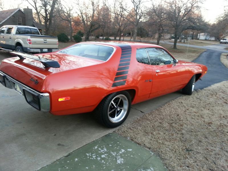

Thanks for the compliments fellas.
To answer your questions:
It is a "factory color" but not for that year or for that model, haha. It's the Dodge orange that they've used on the newer Challengers, Chargers, Vipers, as well as a few Jeeps and Ram trucks. I think it has a couple different names but is most known as "Header Orange" when it was used on the 2012-14 Challengers and Chargers.... My car was originally Rallye Red and I'm just not a "red" kinda guy. The Hemi orange just looks red to me as well, so that wasn't an option for me. I needed an orange orange. I think it works well with the white. It's different. Glad you like it.
And yeah, the front looks lower but because of the 40 series tires, so the overall height of the front 17" wheel and tire is about 2 inches less than stock with 14" wheels and 75 series tires (example: 215/75/14 = 26.7" tall. My fronts are 245/40/17 = 24.7" tall. My rears are 275/40/17 = 25.7 tall). I used BFG's all around. 245/40ZR/17's up front. 275/40ZR17's out back. I believe I'm running 4.5" backspace all around even with staggered front and back wheel sizes because of a little negative offset in back. It's not as tight as you might think. There's room for more tire if you can find the right tire. I did not do any modifications to the car for the wheels and tires to fit.

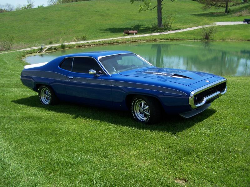

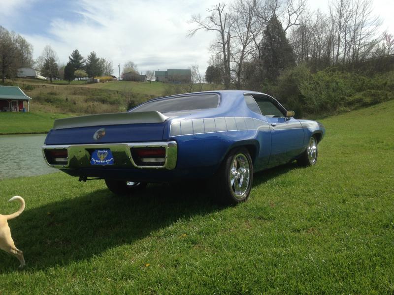

Nose looks a little lower and tall rear tires helped with the rake. Do you think I got the look I was after? Appreciate your input.
Could not find the 265/50/18 in a tread design that I wanted so I settled with 255/55/18 29" is mighty tall.

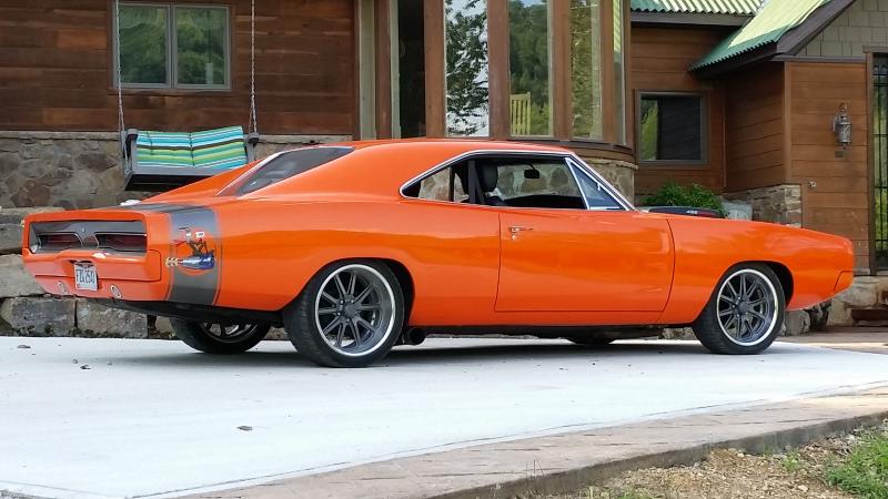

currently running 18" 26" tires all around, on 9.5" rims +15 offset. I'm also running 3/4" hubcentric wheel adapters all around to push the rim out more flush. I believe you could easily get away with 10-11" rims with no problems, no mini-tubing for me.
I should mention I cut out the rear lips on the inside by 1/2" for more clearance
