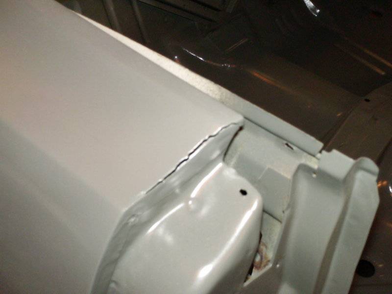

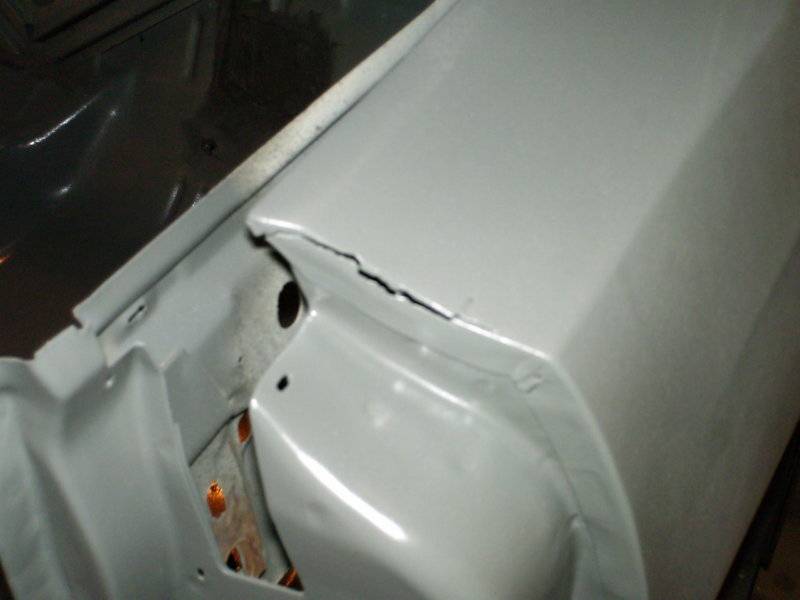

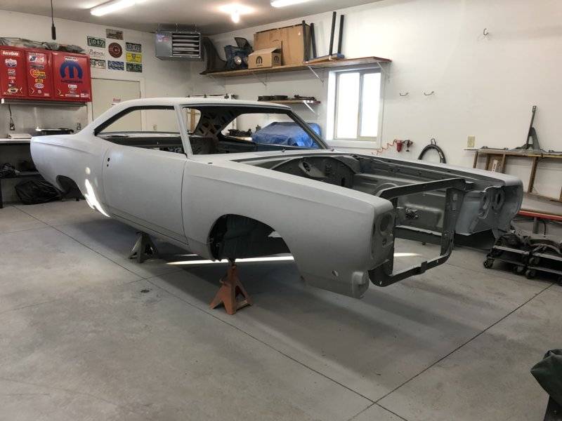

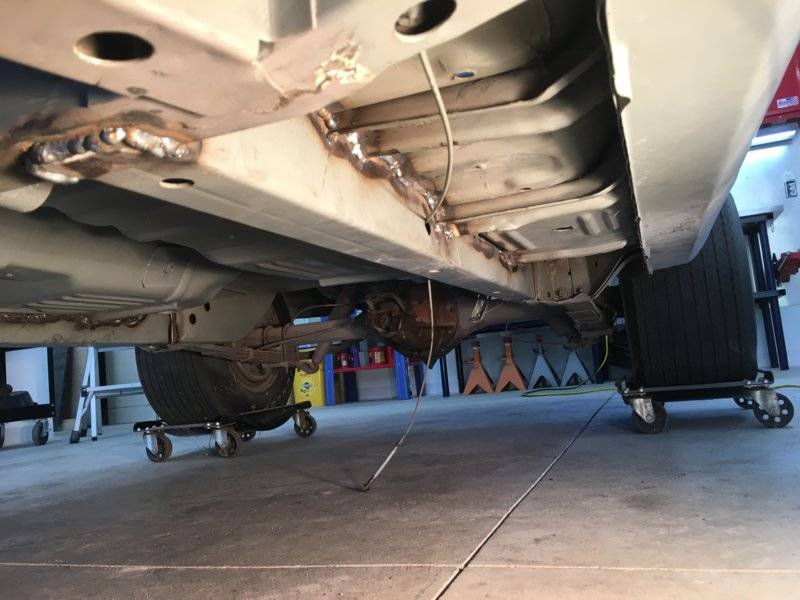

I have a 68 Hardtop that cracked the quarters twice since I have owned it from sheer torque.
The middle part of these uni-bodies are week if you throw any kind of torque at them.
This time around I reinforced the back side of the quarter/door seam and welded in frame rail connectors with all 4 wheels firmly planted on a level surface.
The car is currently sitting on three stands. The front passenger side is about 1/4 inch off the fourth stand because the car is so stiff and the floor slopes on that corner.
Looking forward to driving it.

Yep, same spot mine was cracked. And it was only a 318 originally.
