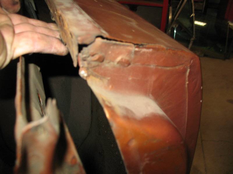

Those cracks in the top of the door jambs on B bodies are from repeatedly slamming the doors, NOT from the
lack of sub-frame connectors! The cracks start at the inside and work their way outward. Every time you close
the doors hard, the top of the quarter gets pushed in tearing the sheet metal a little bit each time. The sheet
metal gets work hardened and starts to tear. Mig it up from inside the panel and you'll be good for another 20
years. The cracks and busted out lead joint where the windshield posts meet the cowl are from the car flexing
from not being stiff enough.

With all due respect, bullshit.
I miged them from the inside the first time I fixed them and after several years, the passenger door was the first one to crack out and it was closed a 10th of the time the driver side door was. Under 500+ foot pounds of torque these cars flex like a bitch without connectors.
We welded in some additional steel behind them this time.

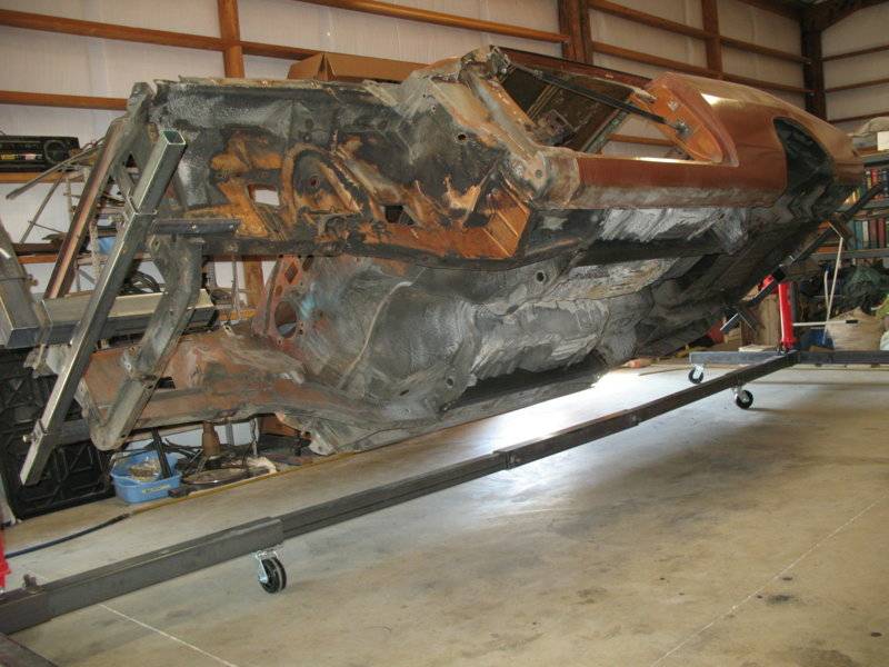

I have seen guys weld them in on a rotisserie but question how much "bow" is welded in.
US CAR Tools recommends they be welded in with the car's feet firmly planted on the ground.
My welder ended up in the emergency room with an awful rash from scraping off the undercoating in summer heat. Ride was transformed. Amazing result with the welded USCartools.
