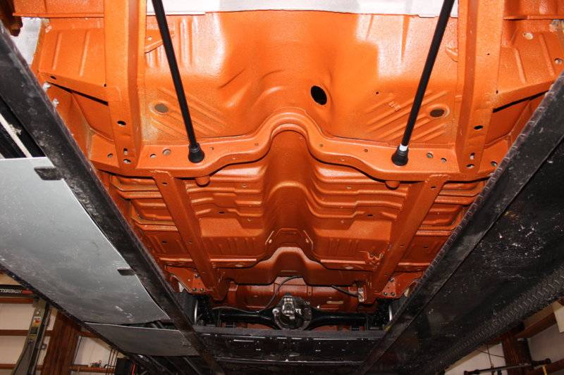

The pics of my 69 Charger I posted was a 99.5% rust free CA car and it looks much better than the earlier pics as a finished product, one might think the connectors factory if not knowledgeable.

I have seen guys weld them in on a rotisserie but question how much "bow" is welded in.
US CAR Tools recommends they be welded in with the car's feet firmly planted on the ground.
I agree it's a bitch to weld upside down, I did mine by setting up the suspension on stands, welding in good tacks on the ends and 5 different places on each side about 1" long prior to putting on the rotisserie. I spent the welding time on the rotisserie, welding 3" alternating sides (in/out) afterwards to dissipate the heat. It's all about patience, I wish I could learn that about paint. LOL
My 70 V-code Roadrunner already has the torque boxes in the rear, and "skid plate" up front. I'm going to have the longitudinal front-to-rear frame ties welded in. US Car Tools
