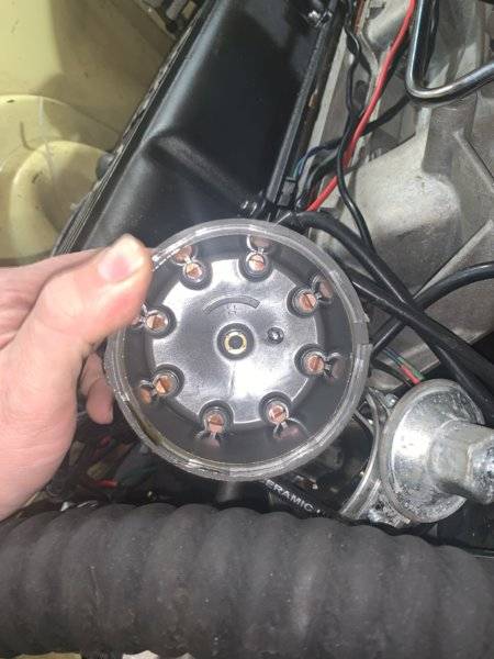

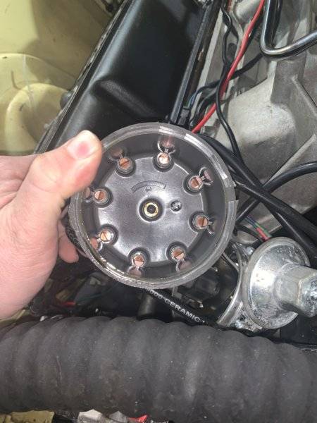

I am asking the hive mind when do we switch the distributor, coil, and ecm box out?
I have an accel super Coil, MSD 6AL and proform dizzy, accel Ceramic plug wires.

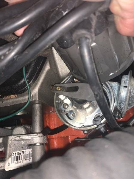

do I upgrade the dizzy now? It starts, runs and pulls pretty decent for a driver. The coil/ rotor in the photo have about 1000 miles on them. The dizzy has about another 1000.
I have been trying to research this topic for about a week, searched on a few forums and no real answers, just "MSD" stuff. Or points to pertronix.
when do you KNOW you need a new system?

If it's not broken or giving you trouble, why bother throwing money at a non-issue?
Well that's kind of the point. The only reason why I have the msd box is because it was on it when I got the car.
I did have an issue at the dyno of it breaking up. But I believe it was a plug issue more than the distributor. It doesn't bounce around, mech advance all in 35 degrees advance if I remember right. It's been a long winter/pandemic

I really don’t see what could be wrong with anything though the cap pictures are hard to see anything on. If it works, leave it.
Does it break up while driving? If not, then what is wrong with the ignition system?
