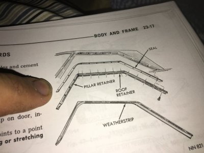

The seal that goes between the roof and stainless trim is a sponge material that is available for car applications from various vendors. It is very similar to the weatherstripping tape that you would purchase at Home Depot / Lowes for home use. The car application is unique for the width and thickness and is relatively inexpensive. The screws that holds the roof rail stainless trim in place is a very unique phillips head that is relatively difficult to come by. A couple of the vendors stock them. They have a very shallow head with a broad shoulder if that makes sense. For the roof rail weatherstrip, I strongly suggest to our customers to try to reuse their originals or purchase the Steele variety as opposed to the Metro piece. The Steele piece is almost double the price, but at least the door glass will roll up into the channel properly. For the weatherstrip that goes on the front edge of the door glass, I strongly suggest using the factory Mopar pieces. Depending upon who you buy them from, the original weatherstripping will be $20 to $50 more for a pair verses the reproductions. Hopefully this will give you guys some insight into those areas.

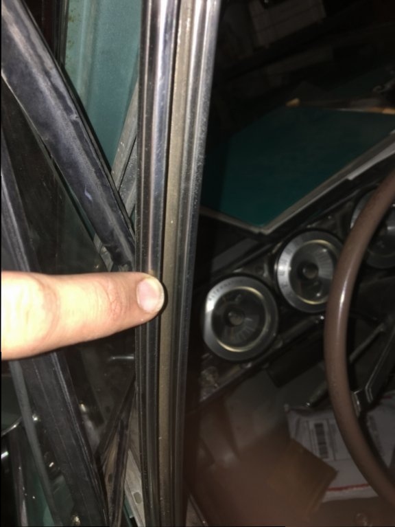

It's on the leading edge of the glass as stated.

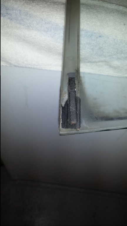

Upon closer examination I can tell what has happened.
All the weatherstripping has disappeared from the glass leading edge.
All that remains is the thin plastic base and some bumper looking things.
It's "bald".
So if I find the MOPAR stuff, I reuse my "clips" that are hanging there??

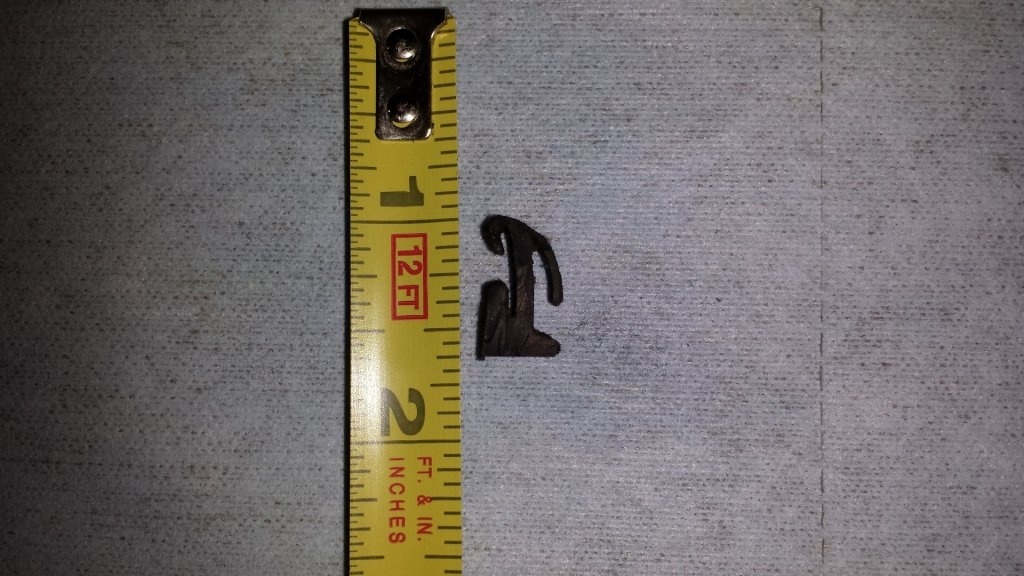

With both the reproductions and the new original pieces, they come with new guides and pins. They may very well break when you try to take them apart after 45 plus years.

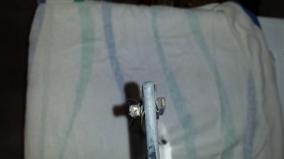

I was able to get my "pins" out......they look OK.....but......
The new ones come with pins.
