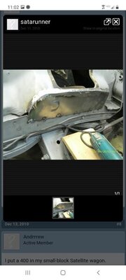

The bb k member 73+ is different then the small block. A stock mount won't work well. Guys have made them work the engine sits crooked and leans. Also you will need to take a small chunk out of the fenderwall on the bottom right corner, I think its toward the back pass side. Shoemaker did make mounts but have retired. It may be that someone else has something available? The left mount is nearly in the same spot for a 440 or 318. I would do a little fabricating to the right mount and get some bb spool mounts 73 and later. Keep the driverside mount where it is and the transmission mount stock and relocate the right one.

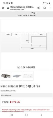

https://www.manciniracing.com/mara440resuo.html <-------- I found this from Mancini, If im not mistaken factory they were rear sump pans so I would imagine it would fit. Whats your input on it?
Originally they had a 971 pan with sump in the middle. If your talking tunnel ram on a performance engine I would seriously consider getting a 6 or 7 quart probably aftermarket like a moroso, or milodon. May have to tweek the front side of the pan so it's clears the small block k member.

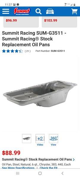

Here is a picture of the mod on the fenderwell. I believe all transmission mounts are the same. The 727 is longer then a 904 but the mount is in the same spot and also is picture of the out of stock oem pan. I would think plenty of used pans would be available as they used this pan in c bodies of the same era...I think.

I think the front may need to be tapped in on this pan w your small block k member, or a k member mod...it looks like the sump gets pretty far forward.
I can say with absolute confidence that a 402 pan will NOT fit a 73 and up K frame, been there, done that, and no way will fit.
