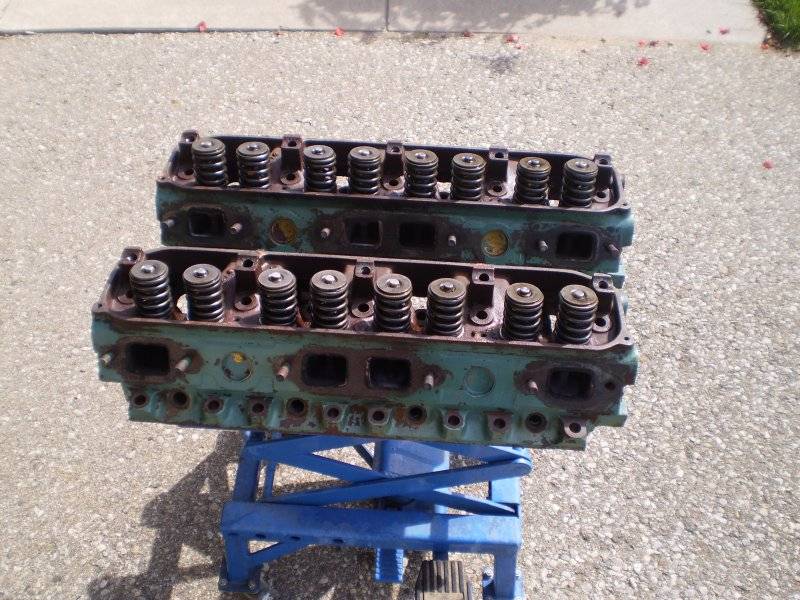

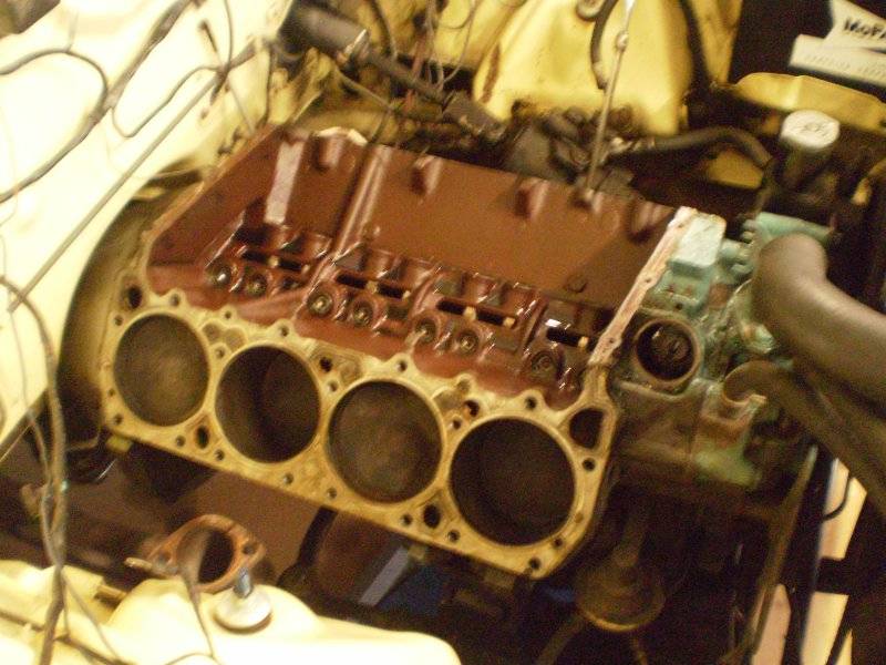

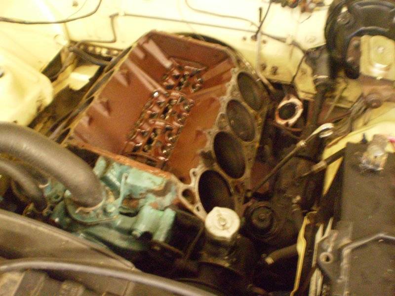

Alternator through bolt sheared off in head. We tried various ways to remove it with no luck. So I decided to swap heads side for side to get a fresh bolt hole. The engine was built 08/89, so am taking this opportunity to clean things up and repaint. Mechanically everything looks fine. Surprisingly little carbon build-up on heads or pistons. Engine had thin shim head gaskets, so I am going to use Felpro .040" PermaTorque. I am going to try a different electronic distributor in it, because it feels like the timing is " floating" around when cruising with the dizzy that was in it. First time it had been apart since built almost 70,000 miles ago, so I guess it was due. Glad it was nothing serious. This happened just before Moparfest, so I rode up in my buddy's red '62 Dart Max Wedge clone. This was the farthest he had been away from home with it since he bought it last fall and it behaved itself well. I see you took some Charger pictures. After hitting the swap meet and seeing the exhibit in the arena, I was too hot and tired to get my camera out and take pictures. There were a lot of early B-bodies there that I had not seen before. It looked like a lot of Car for Sale signs on the show field, though. Thanks for asking.Problems or upgrades Dave?
