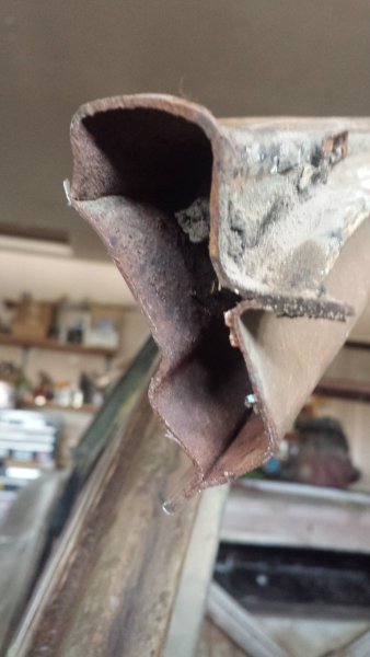

Where does his AMD part go on A pillar?
RXTREME
6:29 PM
Oct 12, 2020
76
42
Houston, Texas
So we have the outer A pillar post and the inner one and then this one which I can’t seem to figure out:
Let me know!
looks like the area you see when you open the door, the stainless part that holds the big weather strip screws to it, and the drip rail is part of it........
calling it a "lower" makes it confusing
what they call the inner must be the part you see when inside the car that's covered by the A pillar trim, and becomes part of the pinch weld for the windshield
Is it steel or stainless ?
hard to tell in the photo
but Looks like the weatherstripping retainer channel piece. IF ...it's in fact stainless
the A pillar is made with 3 pieces, basically a triangle tube....... I've never built one with new pieces; a bit pricey, but a nice option we never had before
the exterior piece (outer) is the least involved of the 3; spanning from the windshield pinch weld to the rain gutter
now I kinda get the "lower, inner, outer" thing
The should make the A Pillar a single item, with all 3 parts spot welded. That would be a pain in the arse to patch repair.
