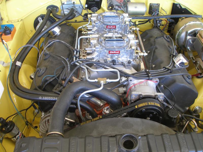

I'm a little confused;
Where does the "Orange" Electronic Ignition module go on a 1970 B-body firewall?
Or, if the Firewall is "to-busy" as mine is, does it get mounted at "Best Operable Position"?
Thanks...
PICS included....

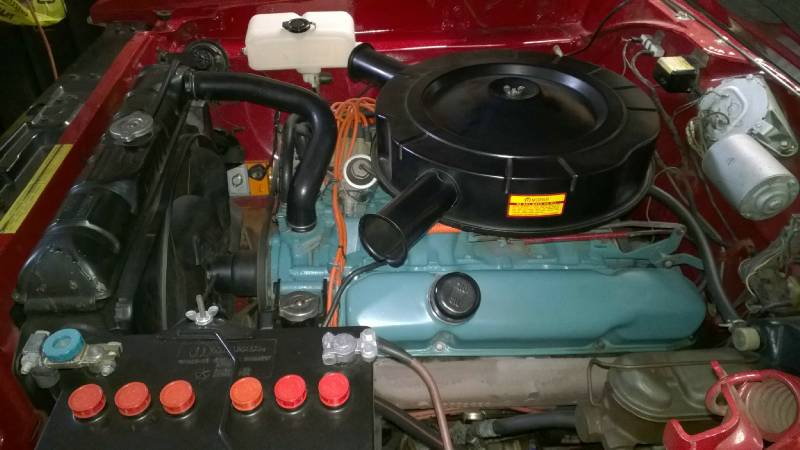

Since it didn't have one originally it doesn't matter where you mount it really. I have seen guys put it under the battery tray to hide it. Mine (on my 67) I mounted about where you have the coil. Minimal wire to run and I already had wires going there for the horns.WP_20140529_004.jpg

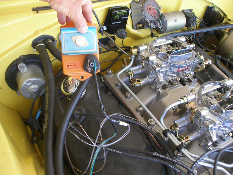

Addition of "Orange" Ignition module to engine bay....
Wiring up the "Orange" ignition module this week.....

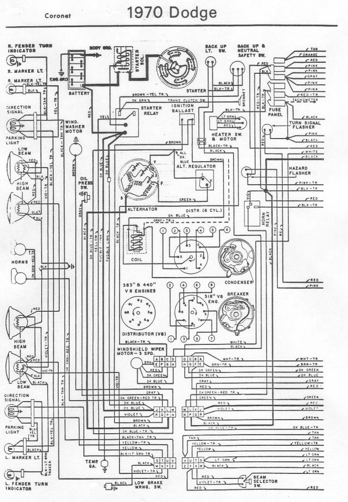

Being a AC car the Firewall is "BUSY"
Lets take a look at the pics here:
Will it fit ?
I DONT THINK IT WILL FIT ON FIREWALL FROM THE PICS AS YOU CAN SEE

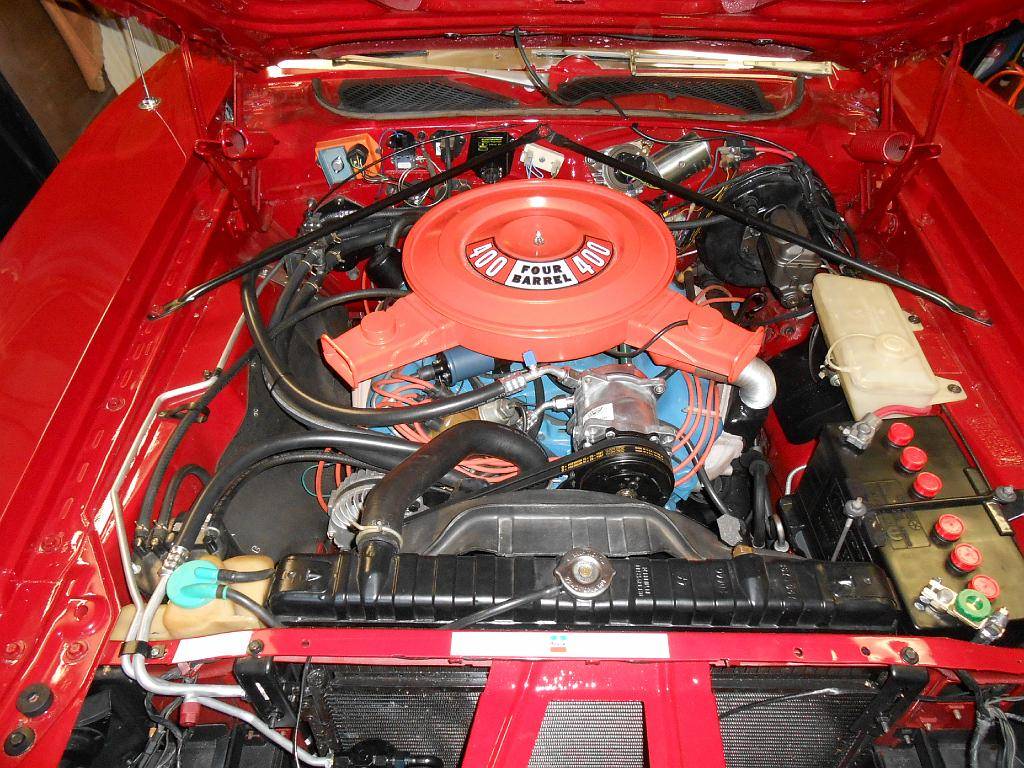

Oh yeah, and it gets busier. Here is my 73 and it's placement.
I still think near your coil is the best. Just my 2 cents.
Looks GREAT ODZ!
In my pics, there is no room above the blower Fan motor
I think you are correct.....
Where my coil is, front left passenger side under washer bottle.
This weekend it will be mounted.
