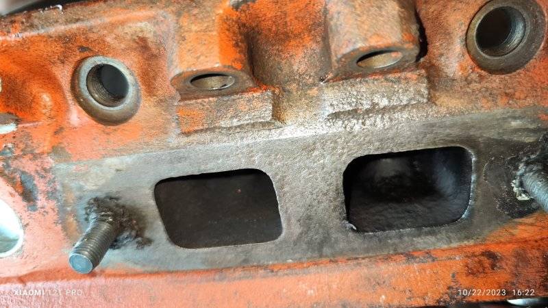

Where is this leak coming from ? Head bolts ? Exhaust gasket?

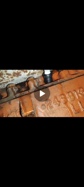

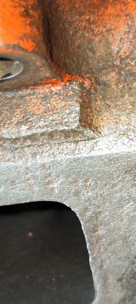

Hey guys , 383 engine has a leak , coming from the gasket bolts or head bolts?
if its a coolant leak.....could be from around a header bolt/stud;from a head core plug; a crack in the side of the head which is fairly common.
Clean it all up and throw some baby powder on the suspected areas, you'll find the source.
That's not much of a picture to go by....
Almost looks like a giant crack in the block...
I believe on the drivers side, one of the rear exhaust studs goes into a water jacket..
Remove stud, coat with sealant and replace.
no leak
They all go into the water jacket.
Borrow a pressure tester for the radiator and put some pressure on the system.
Never mind, looks like you have the head off.
That's where they Crack. Good eye.
