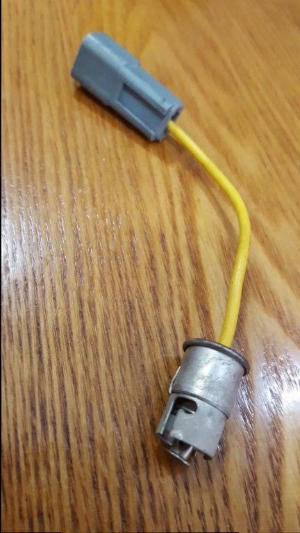

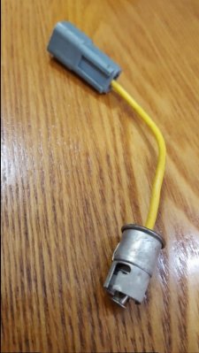

Where is this little lamp cable from?
gumboot
6:49 AM
Apr 30, 2017
7
2
Wellington, NZ
It's about 4" long, yellow, and labelled as 22A and 46399. Single-terminal female connector, and I think a 1445 lamp, although not 100% sure it was the correct one.
It's from my 68 roadrunner somewhere!?
There's no obvious instrument cluster or accessories missing a light, but maybe there is? Would like to reinstall in its rightful place if possible.
Cheers.

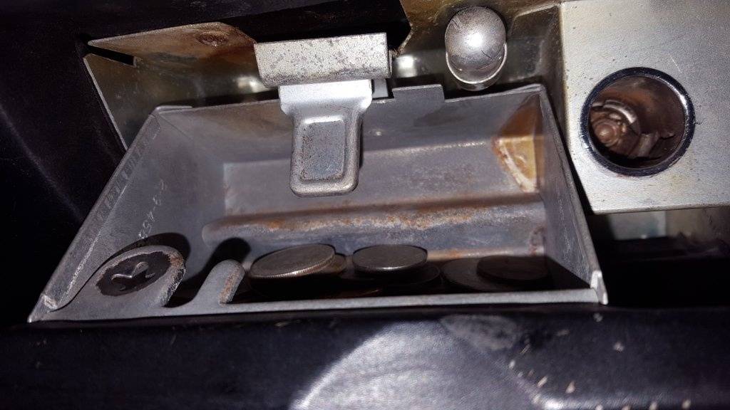

Probably the ashtray receiver light fitting.
The ashtray kind of has a lamp. See this pic that shows the alloy bullet shape thing at the top. However it has only a tiny pinhole that light shines out from. It sure ain't much of a lamp.
Or is that hole in the bottom left of the tray have something to do with it?
The bullet is where I was thinking of. The lamp doesn't show much through the pinhole. Are you sure it came from this car?
Yes very sure. It's been apart for painting, and it's all mostly back together except for a few niggles. this being one of them. It's not glove box either, as that's working, complete with the "lense". Could it be an external lamp by chance?

I just looked in the garage it is the ignition switch lite should have a blue cover where the bulb go's in and a bracket to hold to ignition switch behind the dash hope this helps also I have a extra one with the cover and bracket if you need one

Per my '68 FSM about the only thing yellow is connected to domes. Did RR's have a courtesy light under dash at either end?
Would it go to the glove box or console or ignition switch?? It's not for the center overhead interior light is it?
Yes, as kiwigtx also suggested, it's from my ignition - now I just need to locate the appropriate connector.

If your car has the A01 light package it should be the ignition switch light on the time delay. Trace from the relay taped on steering column harness to a plug on yellow wire.
