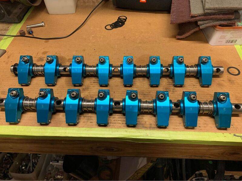

Well I was looking at the new steel rockers for all needed and at 440source are only 40bucks cheaper then there aluminum kits, so wouldn't lighter be better, thx
These are probably the best deal around
https://www.facebook.com/groups/THEMOPARTRADERPAGE
$100.
650_n.jpg?_nc_cat=103&ccb=1-5&_nc_sid=b9115d&_nc_ohc=9VLPH2_prJoAX-80oY1&_nc_ht=scontent.fyto1-1.jpg
Ya exactly same as on 440source for 289 but I don't do FB damm
