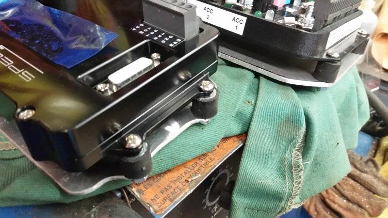

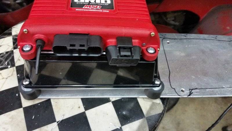

I did the same in my Challenger. Made mounting panels and mounted everything up under the dash on the knee bar with long enough harnesses that they can be dropped for servicing. The switch panel is mounted to my halo bar.

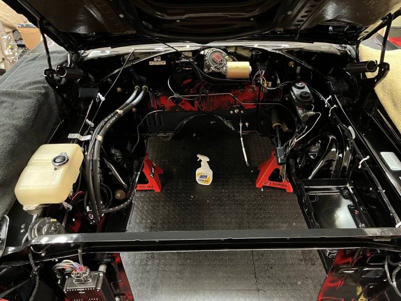

No good hiding places in the engine compartment other than under the battery tray. My solution was to mount it on the front of the core support and make it as unobtrusive as possible. With headers and other obviously non-stock parts under the hood, it didn’t make a lot of sense to put too much thought into it…
