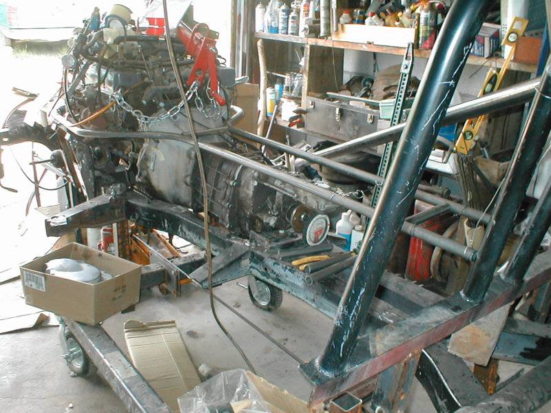

Do the factory manuals show measuring points? (enclosed is a blurry indoor winter photo of the car I am currently doing)
Being unibody, there is a chance that your Charger has sagged or twisted from rust. I would talk to a shop that does frame straightening and see about making sure it is at factory specs and then add a whole bunch of bracing to keep it square as things as large as a floor is removed and replaced.
I'm currently working on a convertible that will end up on a rotisserie, so before removing it from its frame, I welded x-frames in the door openings and across the passenger compartment to keep the rockers from bending when I replace sections of the floors. Being a little British car, my rotisserie is a pair of engine stands. It's a Rover V8 in a Spitfire.
