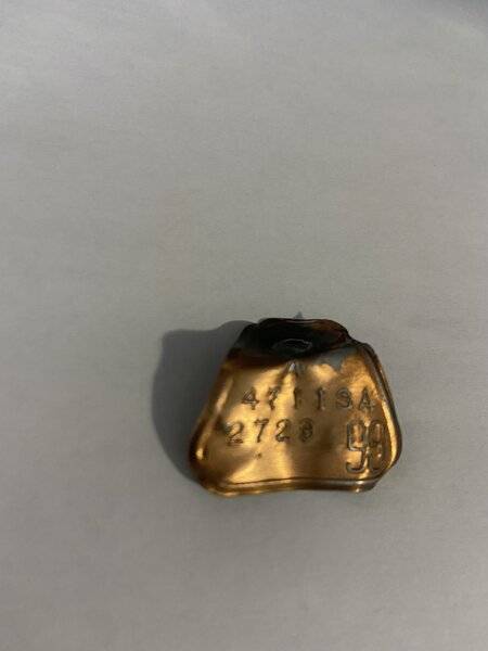

Which Carter carb for my 69 Super Bee, manual trans and factory air?
I have a 69 coronet 500 vert with 383 4 speed with air. Here is a pic of the factory carb tag. Hope you can see it. Yes the right carb is 4711SA 2729 ( 98 )
