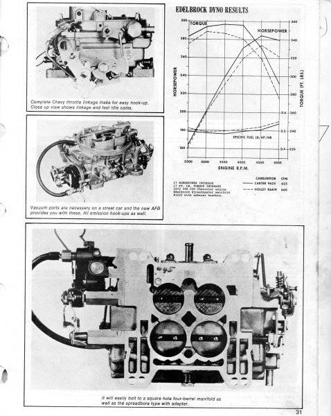

Below, for one: 17 hp more, 17 ft lbs more, & used less fuel doing it 625 AFB v 600 Holley.
A Holley 4150 carb can never be a responsive as a met rod carb because of the tortuous fuel flow path of the Holley PV system.
That's all well and fine, I can cut & paste magazine articles and ads, as well. Back in the day in the garage I worked, we didn't have a dynamometer. Our dyno was the driver's seat of the pants. And the Holleys proved to be an optimum street/strip carb on varying applications.
