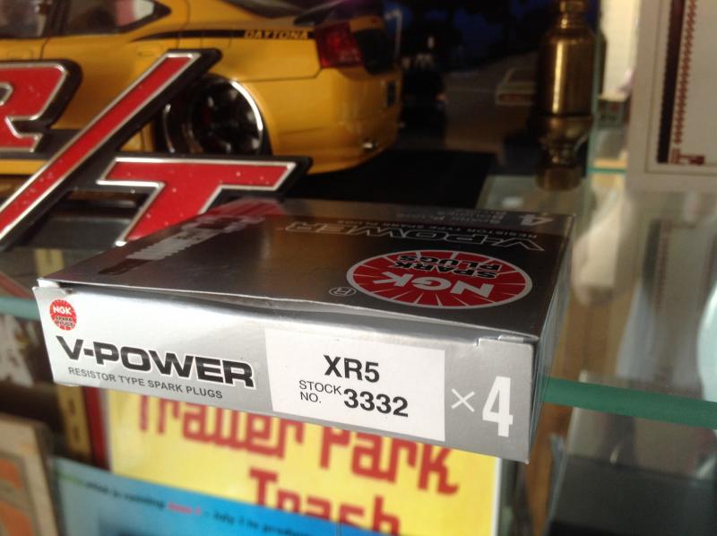

I have a '68 440. It has been bored some with source heads,big cam,MSD with mancini dist. thats about it.
I built it for sunday afternoon drives.
My question is what plugs (make and number) should I run in it.
Thanks for your help
image.jpg N G K's.
