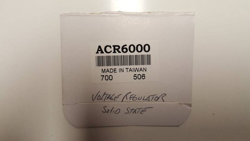

Google ACR6000 voltage regulator. Amazon and Ebay has them.

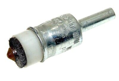

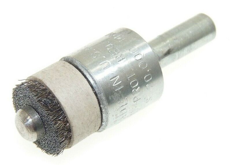

Looks nicer also. Watch the pilot size come in all different ones. I use the 1/4 alot on ECU's

I put the $16 one in my ‘68 Satellite 4 door 383. It still has points (easy to service on the Big Block), and a dual field alternator that I jumped one terminal to ground. I never checked the voltage though. The lights don’t seem too bright.
