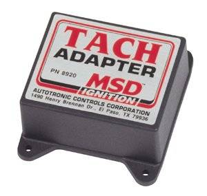

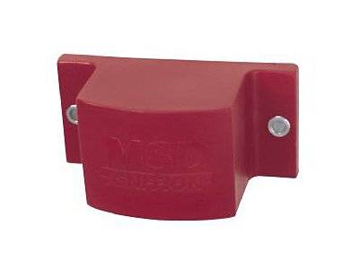

I'm running a MSD ignition box & a factory (dealer) Dixco hood tach. The tach doesn't read right & I believe I need a MSD tach adapter, but which one?
The 8920?
or the 8910?

You can also check the individual installation instructions provided on the links i send how to connect.
If the wiring colours match your setup you might be able to figure it out.
I am not sure what type of rpm gauge you have, either voltage or current triggered type.
Also found below site for modifying your Dixco tach to work with modern type ignitions, although being more expensive i guess then adding a tach adapter.
