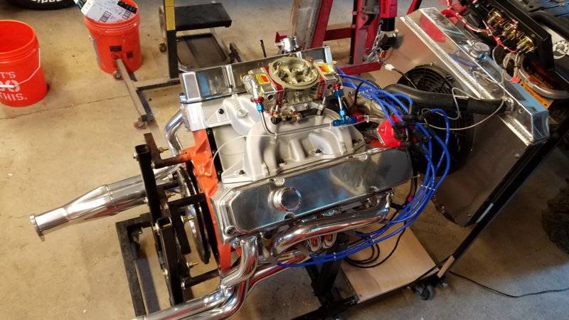

Hi all,
I'm getting ready to put my new 512 in the car but I'm stuck on which transmission to use.
the car is originally an automatic but I really want to get a manual in so I'll need a conversion kit.
The 2 kits I'm looking at are Brewers kit with an 883 or Silver Sports kit with a TKO 500. I don't want to try and source the parts myself as I'd like to get this installed in the next few months.
The 512 should put out somewhere between 550HP and 600HP. The tires and suspension will be the limiting factor in putting the power to the pavement. I'm welding in sub-frame connectors, torque boxes and adding a set of Caltrax bars. the rear end is an 8 3/4 with a 489 case, suregrip and new Richmond 3:55 gears. The car also has all new suspension bushings and springs.
The car will not see the track. It's a car night cruiser and street pounder.
Any advice is greatly appreciated
