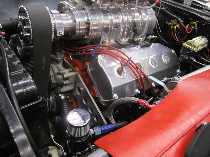

If your using tin type covers,a ball peen hammer will flatten out the bolt holes if they are a little bent. I am replacing all my gaskets with http://www.superformanceproducts.com/ gaskets.They are very high quality and the owner is a MOPAR guy!!
