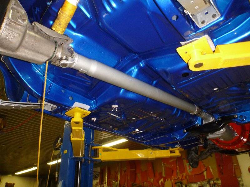

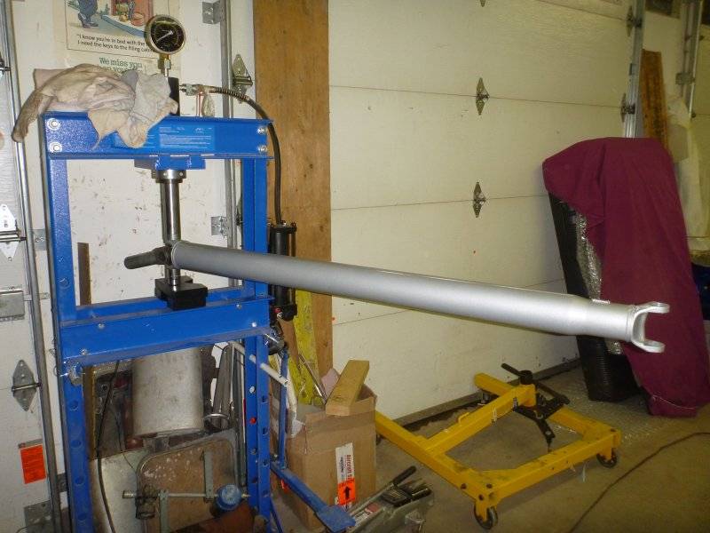

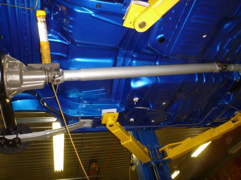

I know this is probably one of those " are you serious?" type of questions but I've forgotten which way it goes! I took my driveshaft out years ago and am now restoring it with new u joints. I forgot which end of the driveshaft gets the slip yolk for the rear of the trans! Does the fat end or the tapered end connect to the slip yolk?? I DID research pics all over the net and I actually found both ways installed. Does it even matter? Sometimes, I wish my 65 yr old memory was better!!!

Ahhh....alrighty then! Thanks Don. The balancing .....would they want the yolk attached or should I leave it off?

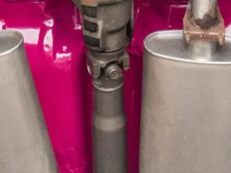

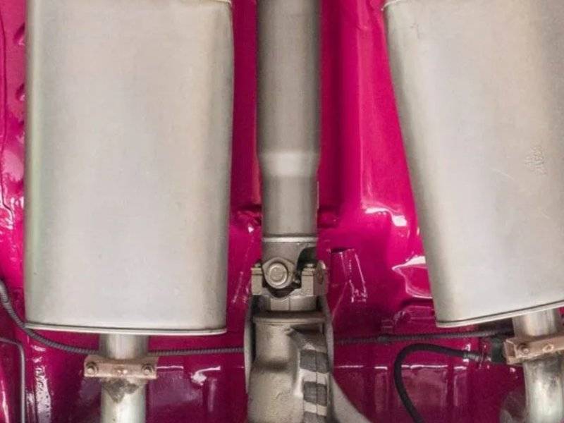

It goes to the REAR According to the factory that built them.
GKent ..I'm glad there was another peep out here that couldn't quite remember either BUT the answers appear contradictory. Could it be chassis specific then? Different A,B,C and E bodies??
Mopared....yeh, I see what you mean. Now my 70 DS doesn't have that ring on it but I can see the tapered end aligned with the diff. Sounds like R413 concurs.

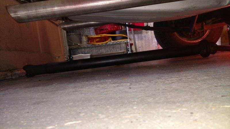

Brings up a question for me though - is the donut driveshaft supposed to be on my '68 GTX to begin with?
