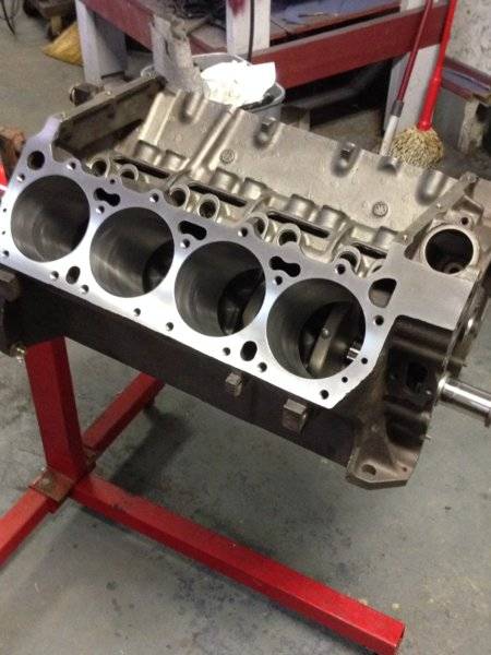

I used a 1972 400 block with the reinforcing castings for my 512 stroker simply because of the quality of these castings. I'm putting out 630 hp but for durability I used a girdle on the bottom to prevent cracking and splitting. The build was expensive (about 8 grand) but the engine is all I was expecting or hoping for and runs exceptional. Being an engine that had never been over bored the machine shop was impressed with the block and it's condition. I knew it was a '72 block because I took it out of a '72 Chrysler but paid no attention to the numbers.
I used a 1972 400 block with the reinforcing castings for my 512 stroker simply because of the quality of these castings. I'm putting out 630 hp but for durability I used a girdle on the bottom to prevent cracking and splitting. The build was expensive (about 8 grand) but the engine is all I was expecting or hoping for and runs exceptional. Being an engine that had never been over bored the machine shop was impressed with the block and it's condition. I knew it was a '72 block because I took it out of a '72 Chrysler but paid no attention to the numbers. For so much horsepower I'm still using the original 22" rad for cooling and have no issues. It's truly a sinister power plant.

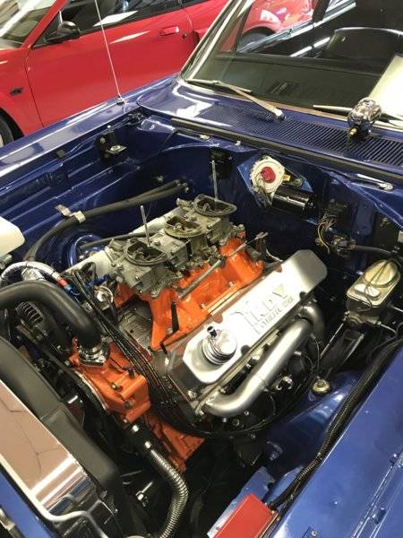

The 400/499 I built in this dart does just fine with a 77 block. That car/combo was never properly dialed and still went 10.0@136 and drives around on the street. My dad has that car now, I’m hoping to play with it a bit next year and find it’s full potential. I wouldn’t recommend a 499 kit though.
Just finished building a (400) 470 low-deck. Be honest with yourself. If you're staying with standard port heads, go the 470 route. If you're going max-wedge, 512. Both of these combinations can be built to make well over 650 horsepower with off-the-shelf parts. Check out AndyF's articles.
Nothing wrong with a good flowing standard port head on a 511, while your leaving some hp on the table the low end torque is awesome. My 4000# B Body runs like a gutted out “a” body with standard port SR’s. Very good street motor.
im thinking now the 470 kit from 440 source with eddy e-street heads, eddy perf. rpm intake, 850 holly DP, with mid-range cam and headers would be pretty awesome street combo. I was worried the heads may be a little small but if you guys think well ported stock heads can work, im sure it will be ok. the car isn't driven a tone (maybe once a week and just during summer months) so its not like there will be a huge amount of miles put on it. to be really honest I just want to smoke my buddy's 68 Camaro 396 when we are out terrorizing the town :)
