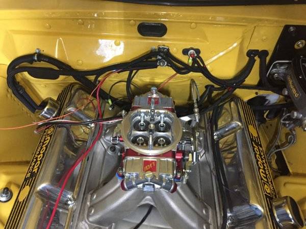

To chime in.. Lots of good info! I was thinking all the same questions. Found a later 400 block ans was thinking 470 stroker. Guys at 440 source asked why leave hp on the table if you're going to pay the same price for a stroker kit. 470 vs 512.. It made sense to me. However, I was concerned it wouldn't be streetable and tough to drive. I went 512 and kept CR lower 9.7 = pump gas! Also went with the CNC stealth heads and 571 roller cam. Been great! I can give more specifics if you need but it's just been great! No issues. Plenty of low and haven't had space to find top end yet! Good luck on your decision and build.. One thing is it will be good either way when you're done!

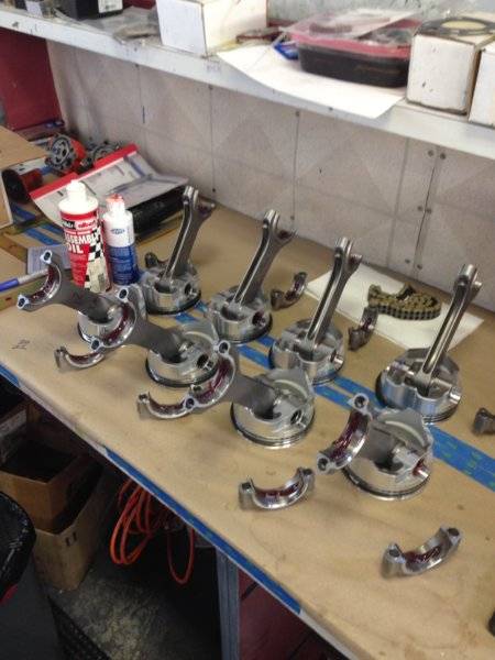

So I’ve read about the super short piston on a 512 beIng less stable. Not really the case?
Yea, you’re gonna have a bit more piston rock. It may need rings sooner than a longer piston. But, are you gonna drive it 100k miles? If it’s only gonna see a few thousand miles a year, the 511 is still gonna last a long time. Provided good machine work, proper clearances, and a good tune up. In my case, I hammer my stuff hard. I know in 5 years time I’ll be pulling it down for bearings and rings anyway. But that’s the case for any performance engine. You hammer the snot out of a 470 daily itlll still need maint items (bearings, rings) every so often. So will a 440. Kind of depends on what you wanna do, would I put a 511 in a car I want to drive 10-15k a year? No, I would put a stock stroke engine in it.
511 piston
511 piston
