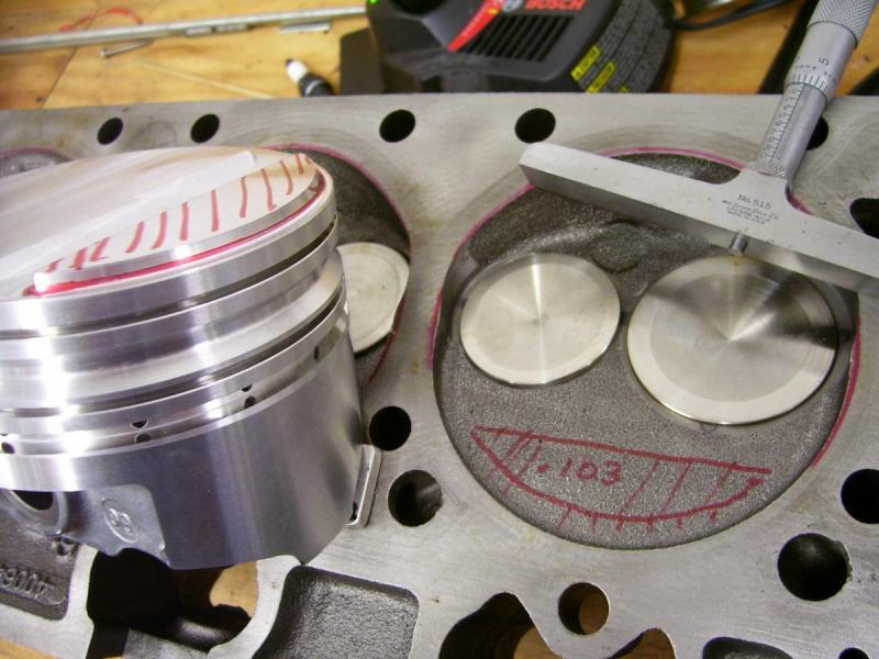

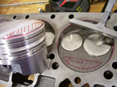

i've been getting some kb184 questions so i decided to post a pic of what i do. i've tried to highlight where the quench dome fits in the open chamber recess. i also show a depth mic i use to measure the recess in the head and to measure deck height when the piston is in the block at TDC. hopefully the pic is helpful.
we get on these forums, type a bunch of stuff trying to convey an idea but it's not as good as something visual. when i first went thru the kb184 thing i was all **** trying to be perfect and basically driving the machinist nuts. i learned that this whole thing is very simple but does require taking a little time and measuring. anybody who measures piston deck height can easily do this. all your trying to do is turn a non-quench chamber into a quench by using a piston rather than a head casting. always keeping in mind that the top of the piston is actually the floor of the chamber.

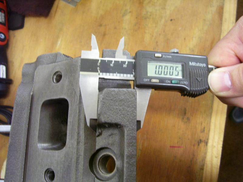

for those messing with iron heads and wondering if they've been milled here is a simple check. the thickness of the deck at the lower row of head bolts should be 1.000" or very close on an un-milled head.. the depth of the recess in the open chamber heads should measure very close to .100" for an un-milled head.
