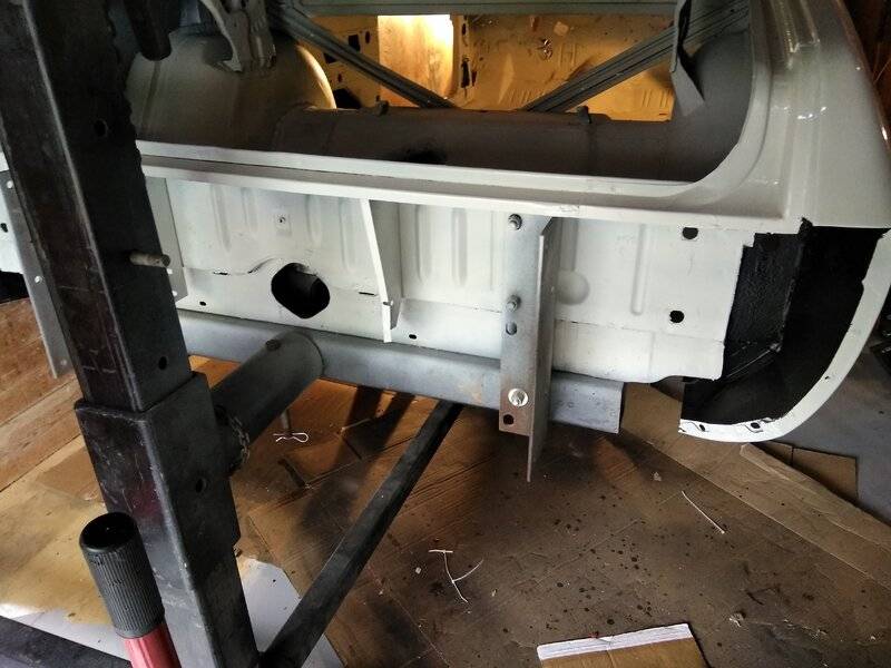

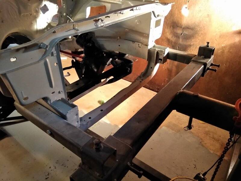

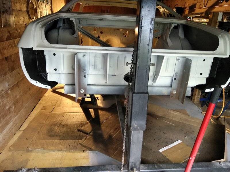

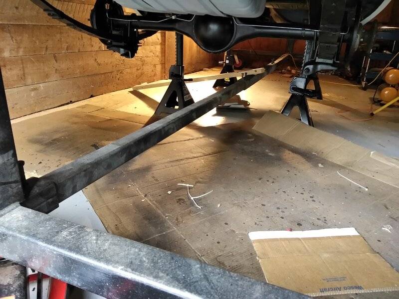

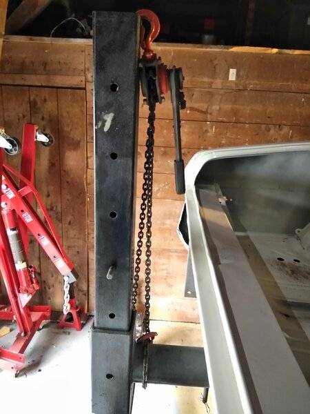

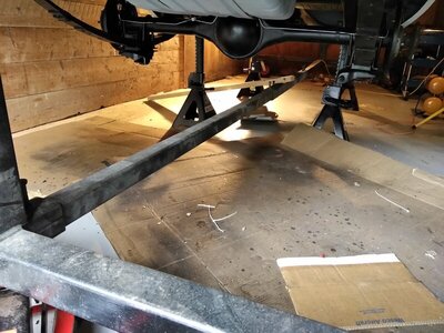

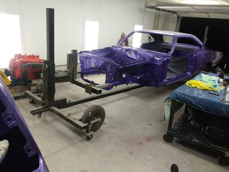

I build my with telescoping legs, 8' rubber wheels, and with heavier steel that anything I could find on the market. One the car was balanced on it I had no problem rotating in by myself. I spent around $800 with paint and hoists and used it for three years and then sold it for $1200. I must have did a good job on the build because it was bought by a body shop. Here are some pictures of what it looked like.
