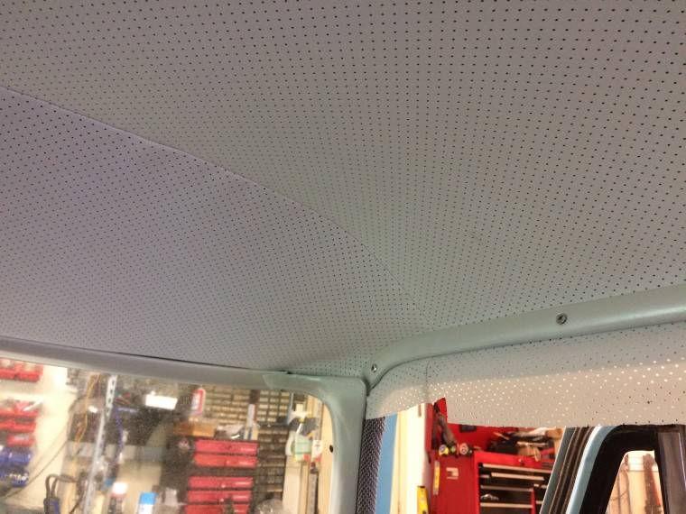

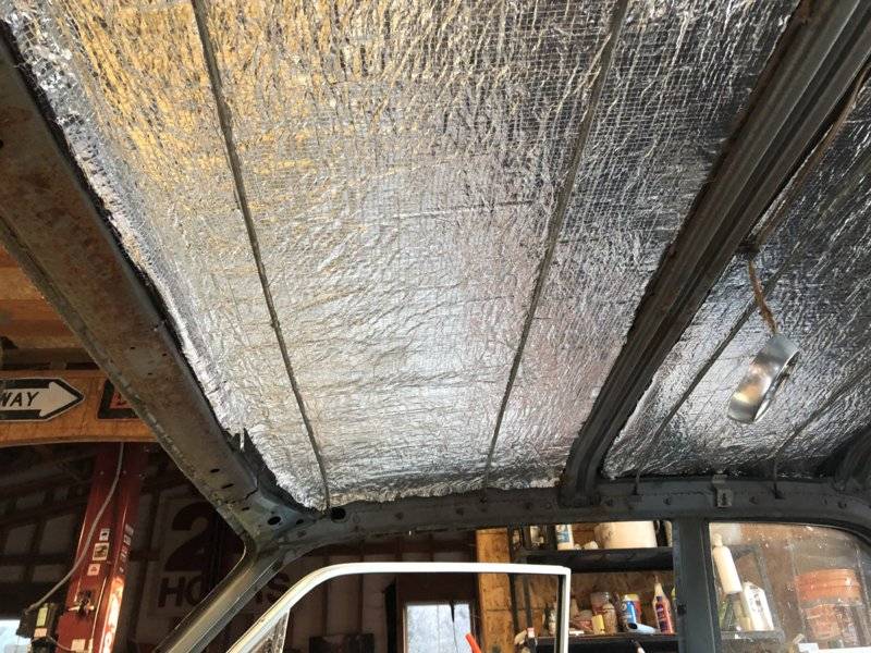

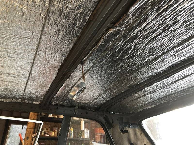

Also note, if I do another one I'll be misting flat black onto the "tinfoil" as if you look up at the headliner you can see it shining through the perf holes.

Great idea regarding the foil backing showing through. I was tempted to glue the jute on with the foil against the metal but figured it would probably peel off and leave the heavy jute resting on the top of the headliner making it sag!
