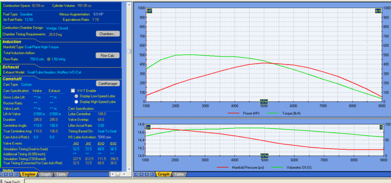

Strokers don't lack low end torque and 318/390 strokers are no exception. Maximum torque starts a bit past 2000 rpm and continues to 5000 rpm or so. Perfect for a street engine.
