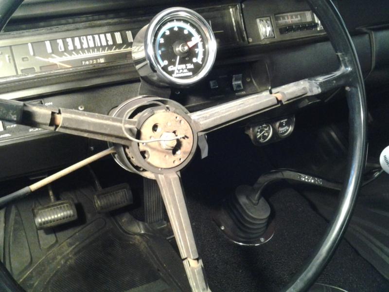

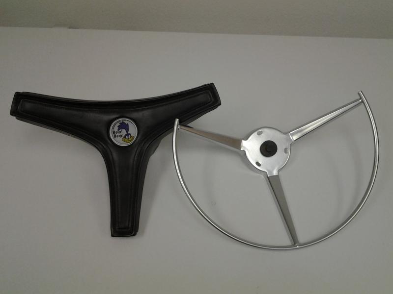

Working on a 69 RR, I am missing something that brings the horn ring and the column togeter. Here are pics of what I have... 20150524_100458.jpg20150524_100245.jpg
On e bay item number 351410669847 looks like it is close??
Thanks for help from you experts.

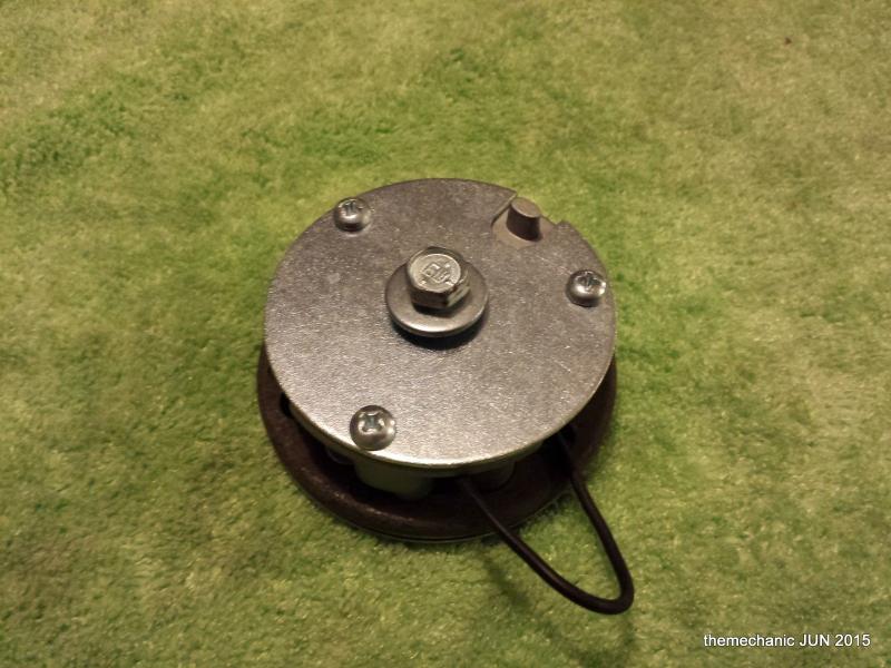

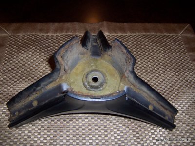

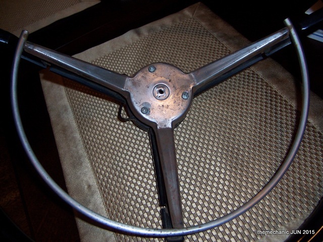

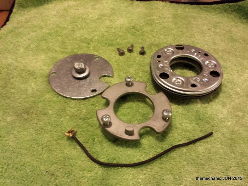

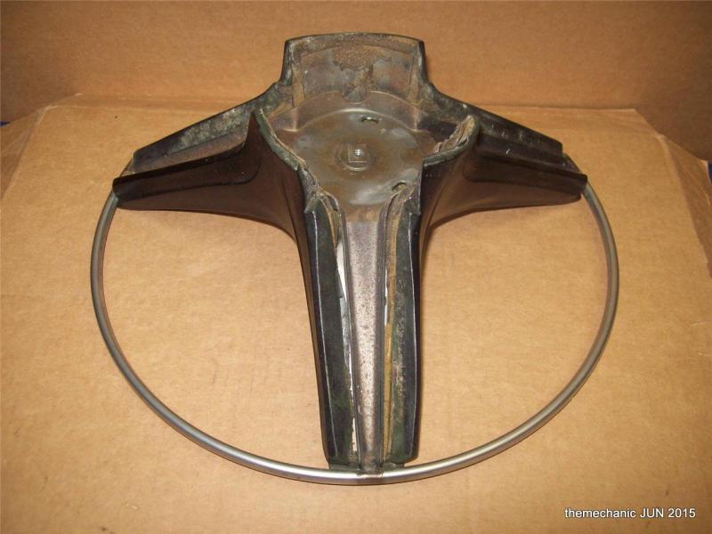

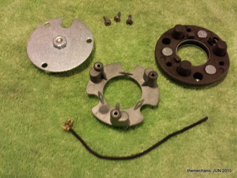

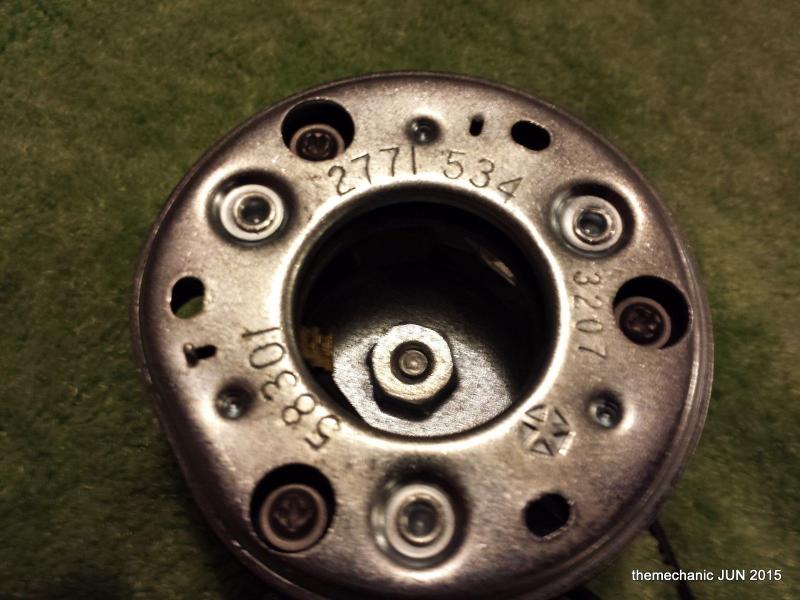

Looks all there to me, I just did my entire column on my '68. The horn ring attaches to the column with 3 little screws ...
you need a horn switch and plate
Thanks to you all, cudajunction, themechanic, gearaddict, moparparts for the info and pics, I got it coming together now. This colunm is a wealth of information.
