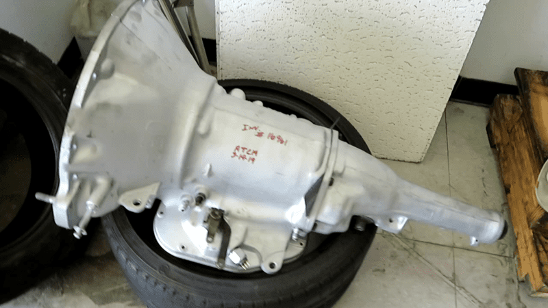

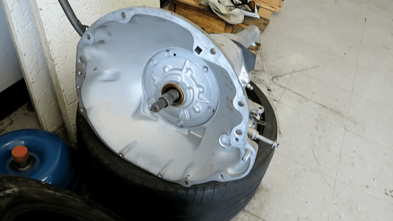

Yeah, seems a bit high, but that does include removing the trans and getting it to the trans shop. The actual trans rebuild and the rebuilt torque converter were $1390 which still seems high, but I wanted it done to go behind the rebuilt engine. Since I don't know how to do it, I pay someone who does.Almost $1700 for an overhaul of the 904. Yikes!
Sweet ride you have there, looks really good!
It definitely cost a few hundred more to have them rebuild the original than it does to just swap for a rebuilt.Yeah, seems a bit high, but that does include removing the trans and getting it to the trans shop. The actual trans rebuild and the rebuilt torque converter were $1390 which still seems high, but I wanted it done to go behind the rebuilt engine. Since I don't know how to do it, I pay someone who does.
I did not know that, and Jim let me know that the guy with the shop next to the engine builder would have done it for about $400 less, so anyone following this thread, pay attention and learn from my $400 mistake!!!It definitely cost a few hundred more to have them rebuild the original than it does to just swap for a rebuilt.
It would be interesting to get an answer to that question!!!Some of it must be the mopar tax. Friend at work just had his 66 mustang auto rebuilt. Exactly $902 including R&R. I asked him to get a quote for a 727 when he went to pick up the car. He said the guy sorted smiles and said "mopar 727? About 3 grand". How can there be a $2100 differential in price between these cars?
