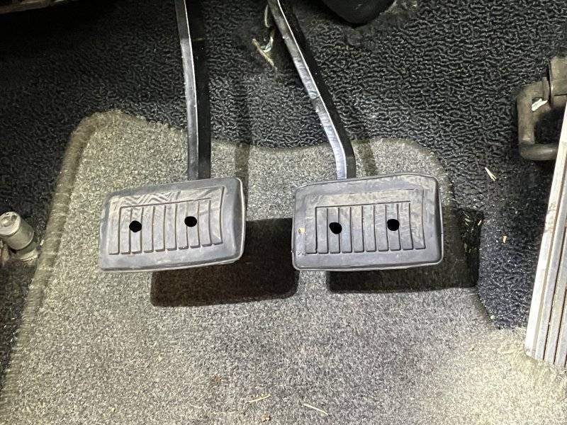

Today I was in the shop digging out some early A body parts I’m looking to give away and in a coffee can I found these:
They must be original. They are harder than the new ones in my car.
They look the same. I’ll save these and see if they fit and stay in place once these newer ones fall off again.
