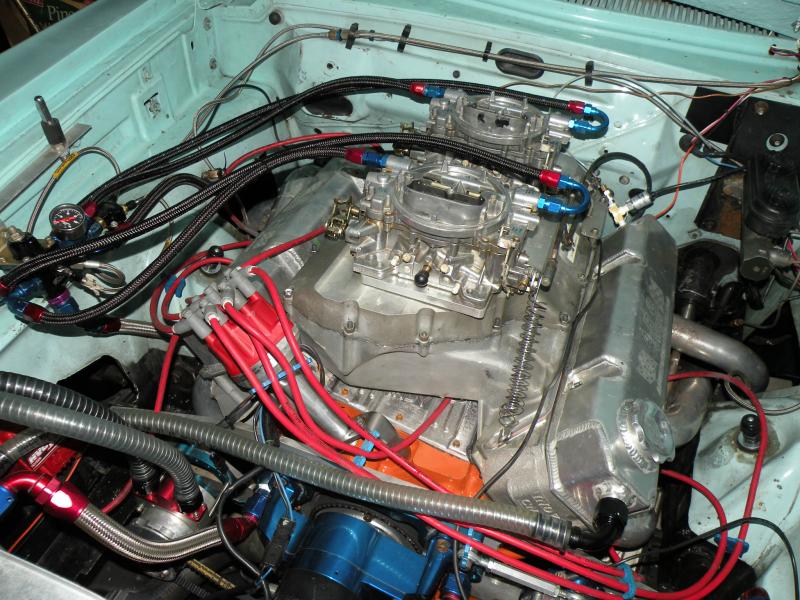

This is on a dual quad indy inline crossram

Never heard anyone say that about them. We use two Eddy 800 carbs on my brothers 499 but its nowhere near as much eng as you have there. His has run 10.20's at 3600 lbs and we have no trouble tuning them rich enough. Seems alot of guys run the Indy crossram like that with the Eddy carbs. I believe Kevn who run the Bounty Hunter Bob Banning white 64 Dodge runs that intake as I think he runs Eddy carbs. I believe he has run 9.80's with a 500 plus eng and I dont think he uses Holleys as I believe he uses Eddy carbs. Dont think I have seen anyone use Holleys on that intake ?? Ron
