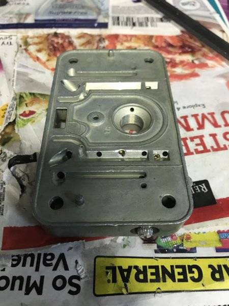

Yes, stick to a 2 circuit. Anything out of the box will require some work If you want it to run clean. My experience is once dialed in on the bigger motors they drive around just as good as a 4150. If you can get a good buy on the older Holley dominators those can also be modified to work good as well. They require some hard parts though. This was an old 8082 I built for a hemi. Very good running carb.
