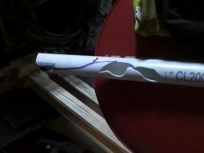

rated for 200 psi air compressor max output 90 this piece is 3ft long still missing at least 4 ft
Why didn't you use the SCH-40 3/4" pipe that's rated at 480 psi??? NEVER use the thin wall stuff for air....

Reading that schedule-80 spec sheet from Harvel, it mentions nothing about being allowed for compressed gasses. The pressure rating is for water, which is a constant dimension fluid so it doesn't expand through a rupture like compressed gasses do.
The section on the left of that page has a menu that includes 'Testing' in which is specifically warns against any testing with air in the system during a water test, and Caution: Compressed air or gases must never be used for testing of rigid PVC and CPVC piping systems
Further, the 'Cautions Areas' on that page specifically warns that GF Harvel does not recommend the use of PVC or CPVC piping products for the testing, transport, or storage of compressed air or gases
It also brings the warning that PVC and CPVC piping may not be compatible with oils in the system from air compressors.

NOTE: Interestingly enough, after a second viewing of your damaged PVC 3/4" Schedule 40 pipe I notice some "Blue" in very close proximity to your damaged area.
Did you use a "marker" to highlight the damage OR is it left over residue from either "Hot Blue" Glue or Primer?
If so, the chemical in the Hot Blue Glue weakens the surface area on the PVC pipe.
The maker of Jet Hot Blue specifically states not to have any "GLUE" on surronding area, only the joint. It states to wipe off any excess. (Read the label)
To me, thiis is exactly why your pipe failed in that spot.
