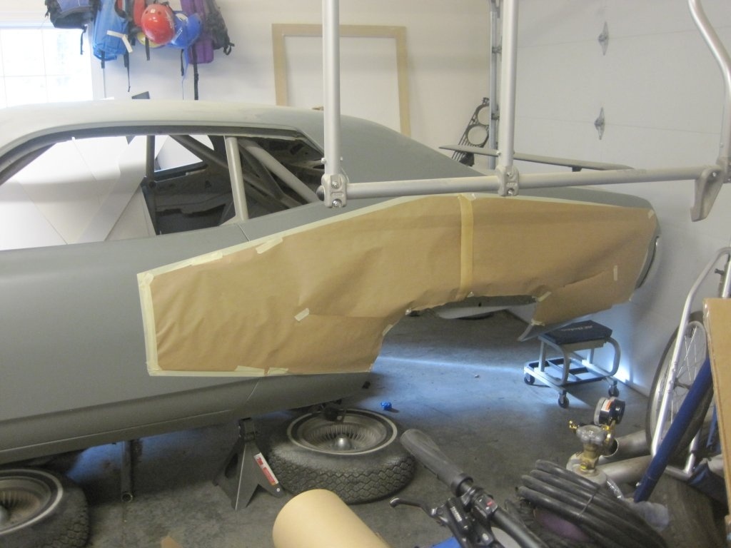

Let me update the build engine wise. Going with a 540 lower compression for pump gas. I don't have a specific turbo picked out, single or twins. Planning on efi with a high end boost management system.
I don't see myself taking this car in a strictly drag stop direction. I like the idea of a more autocross set up.
I would love to hear thoughts on how best to proceed
Currently in hold mode while the engine is being built.

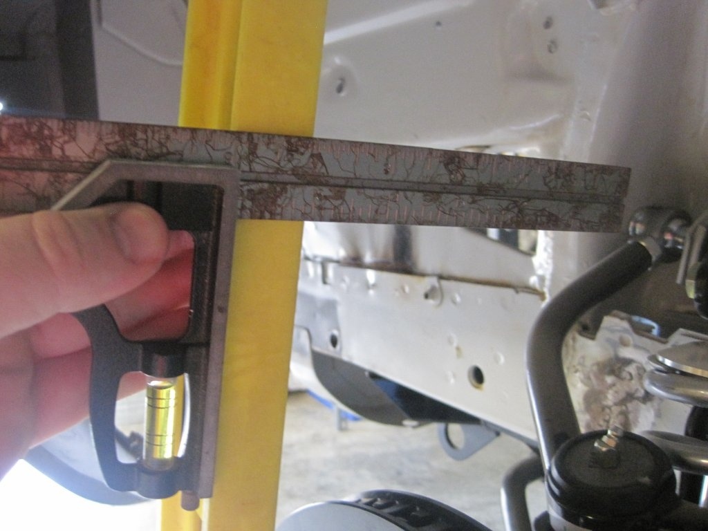

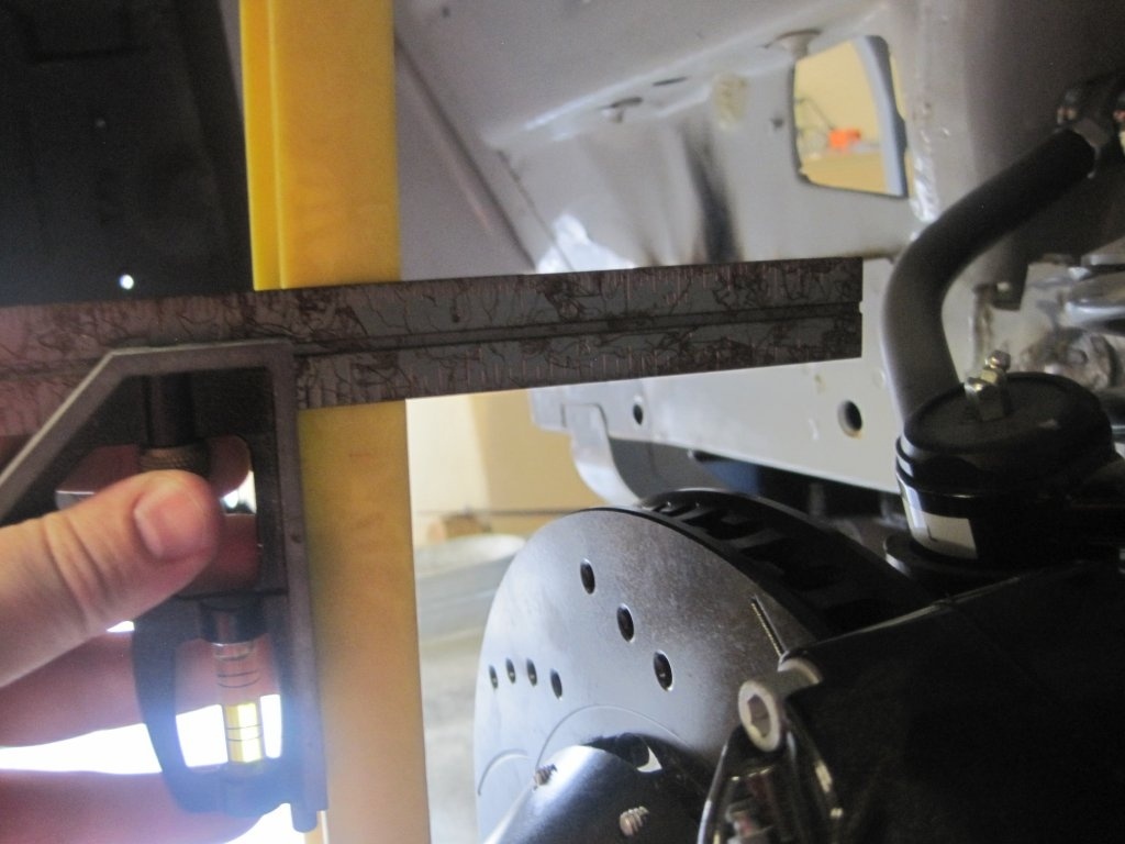

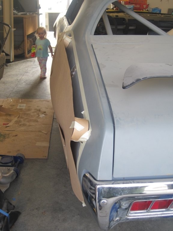

I was measuring today while working on the 4 link and have tons of room so I may not even widen the car

What kind of wheels are you looking at currently? Like I said, you probably could easily get away with 275's on the front (I've heard it's possible with the right offset/backspacing, even on a/e-bodies), although, my 255's are a few mm's away from rubbing the inner fender/frame on full lock with my current wheel selection. 18x12's w/ 355's are fairly heavy, do you want to add that much additional unsprung weight? You're going to smoke anything regardless with your 540 unless it's a non-DOT approved drag slick. I would REALLY look into 305's to keep the cost relatively reasonable, possibly some Nitto NT05R's for the rear. You're looking at around $1,500 w/ tires-wheels-mounted-balanced-shipped if you go that route. On the other hand, 355's are available at around $400 ea, but I can't find any with a decent sidewall. If you really want that 'wide track', I would definitely only go 325/45r18, something like this possibly on the rear;
