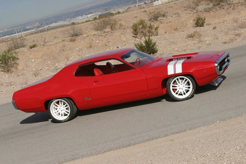

I ran 275/35/18's on the front of this car with a Flaming River 16to1 manual box.
It was UN-driveable..I swapped in a factory manual box.It was much better.But tough at slow speeds.Like parking.
7 inches wide, no issues... as long as you are moving, even a little bit. Back out of a parking space, let go of the wheel, drive ahead and mine will straighten itself out, then grab the wheel again.
