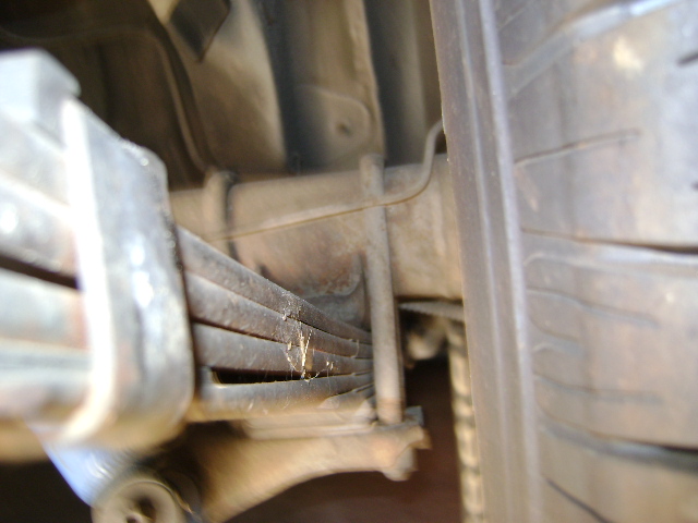

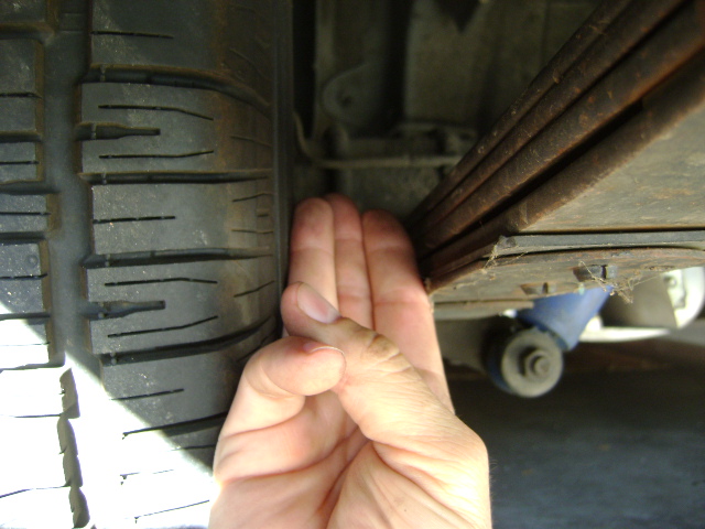

You sent me a message about the wheels on my '69 Coronet,w/15x8" wheels w/4.5 backspacing and 275/60/15 radial T/A's,I wasn't able to send photos from my file for some reason,anyways, I have some photos for you,
from the leafsprings to the tires you have about 2 inches,on both sides,on the outer edge wheel lip,you can stick your hand up between the sidewall and wheel well trim.
this is the biggest tire/wheel combo you can fit on these cars without rubbing,don't let anybody tell you any different,I've had this car for 30 years,and I've had every type of tire/wheel on this car, I can load the trunk up and have a full tank of gas,and they don't rub at all!
as a matter of fact I went to "Mopars At The strip" in Vegas this year (600 mile round trip) I took a 512" stroker kit,Crank,rods,pistons,etc. about 150 pounds,plus I had some tools,and a bunch of other crap in the trunk too,probably over 400 pounds total,no problems.
sorry for the crappy photos!

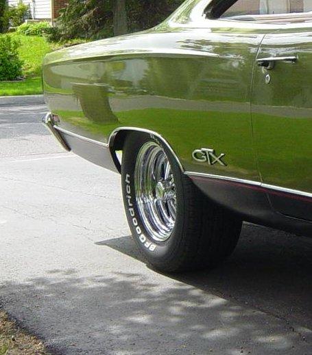

We put Weld wheels on a '69 GTX that were 15x10,with 295/50/15 T/A radials.With that width the back spacing was 5.5".They do not rub except maybe at extreme angles/bump,like a bad curb.I don't have any digital photos,but if i find one I will scan it and post.It's a white car,stripe delete and a blue interior,it looks bad a$$ with those tires and is worthy of a post!

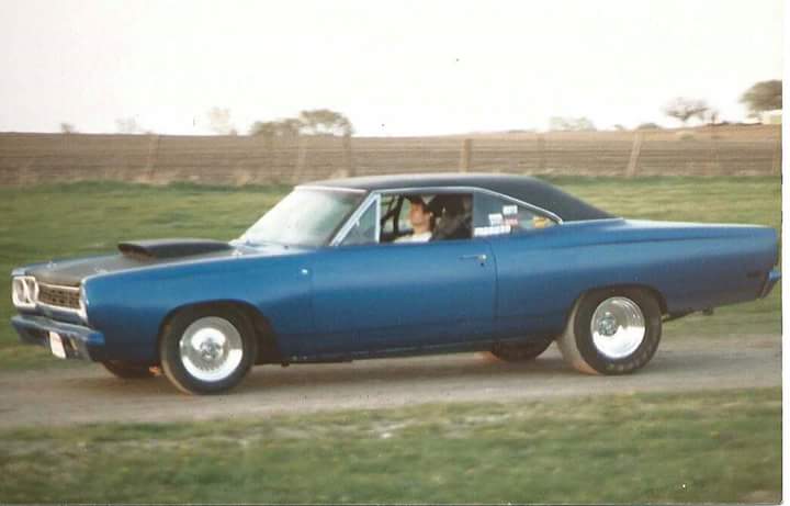

I ran that exact same combo on my 68 Roadrunner, since sold it. It rubbed in extreme angles.

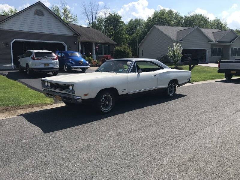

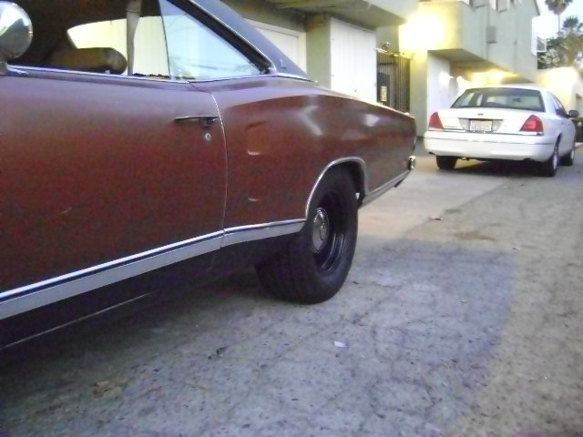

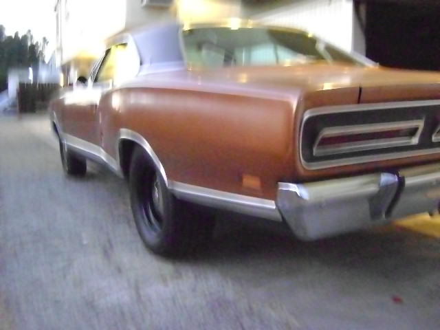

I have the same car but mine is white, I been wondering how it would look in dog dishes as mind still have the factory mags, do you have any other pics of her from the side? Hopefully you still have her! Thanks in advance

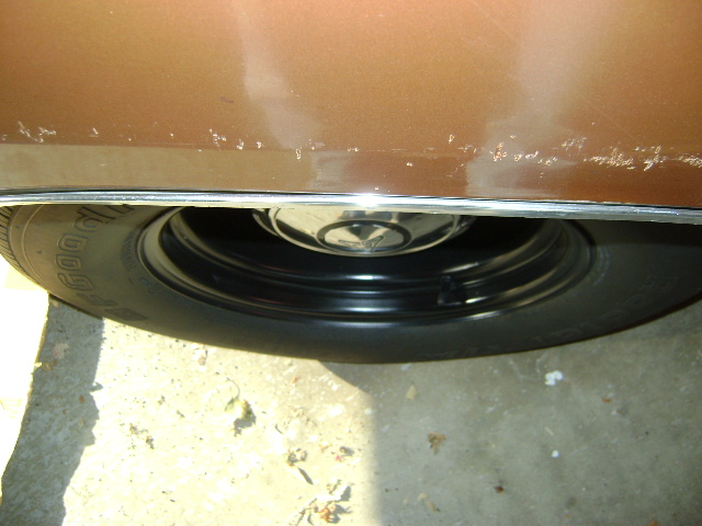

I agree, the redline dog dishes are killer, I also like the plain black steel wheel, something about it is so aggressive, Not sure if I’m just used to the mags but feel like they look nice on the car, need to adjust the ride height in the front still though

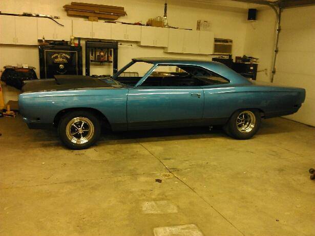

I like the magnum 500s & old school slots. These are from stockton 15x10 & 15x5.

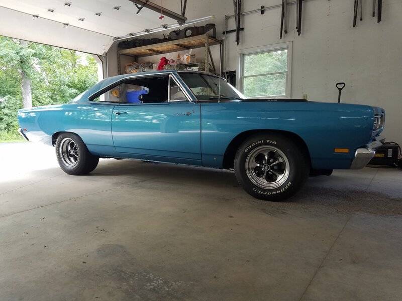

I am into the day 2 look as well. 15x10's on the rear with 275/60 tires.
You don't have to "if" you get the correct back space. Usually 5.25-5.5 depending on the tire. How ever I did minitub because I may go even bigger. I ran the old polished centerlines with the 5.25 back space and they were perfect! 1988
