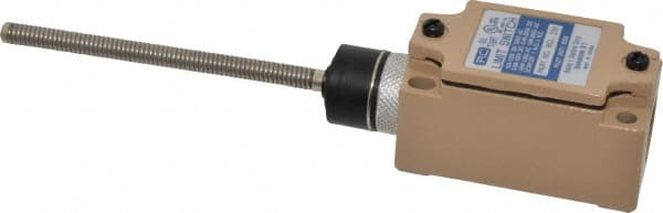

There's no fun in that!!!.. I haven't put a car into the ceiling yet on the 2 post lift. BTW, off to the shop to cut a hole in the ceiling... lolYou should fabricate an "up" limit switch to stop the motor so you don't accidentally drive that wing into the ceiling.
A whisker switch can be easily placed to kill the motor power.

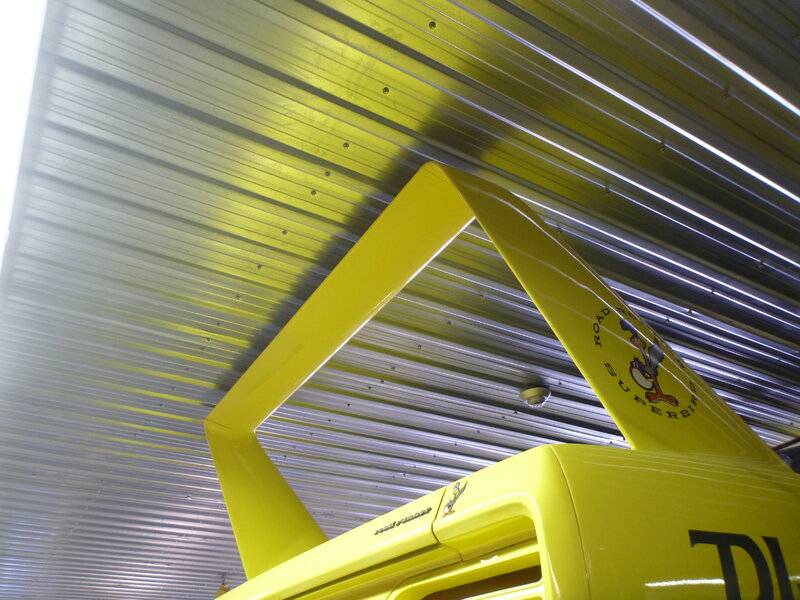

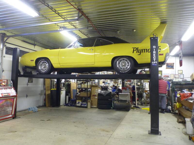

Gotta put the Bird in a little bit at a time...

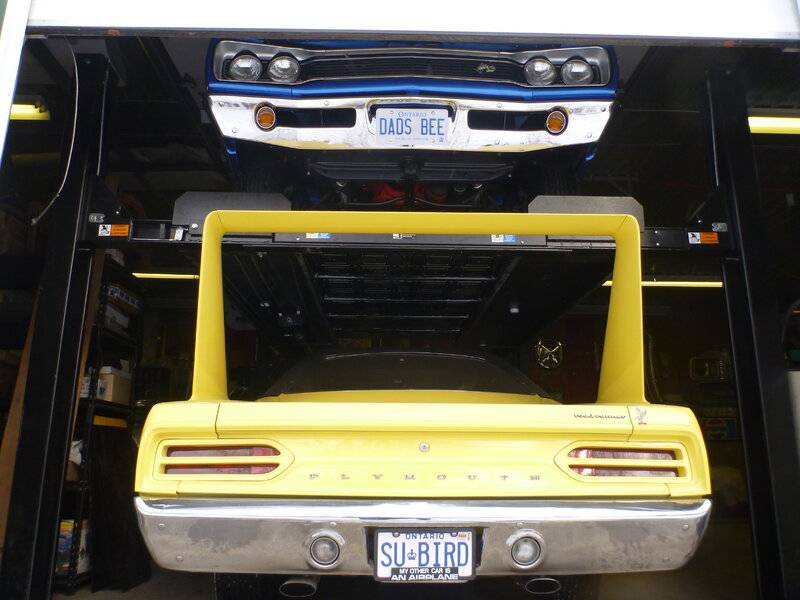

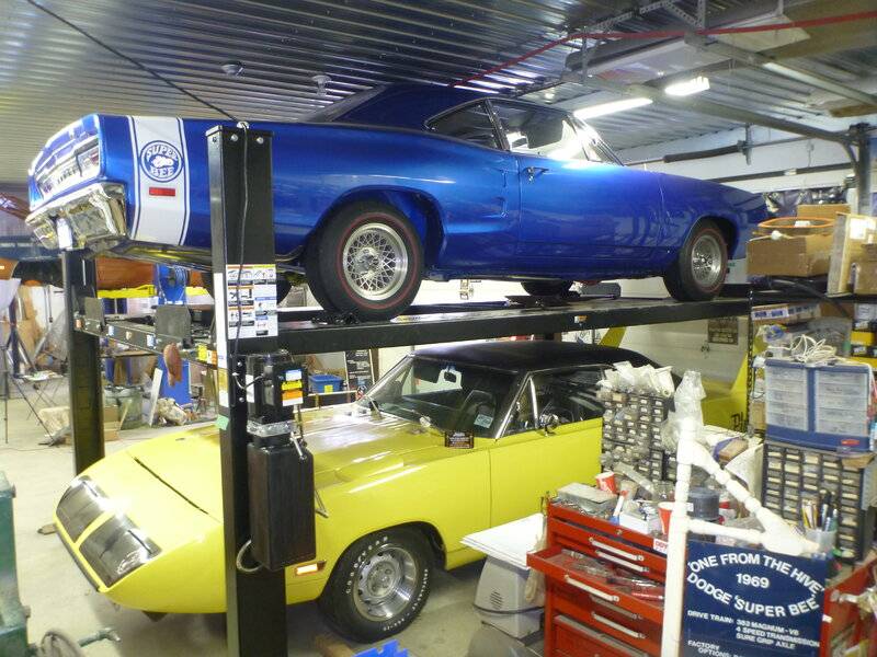

Bunk beds.
Lots of room.

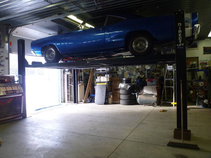

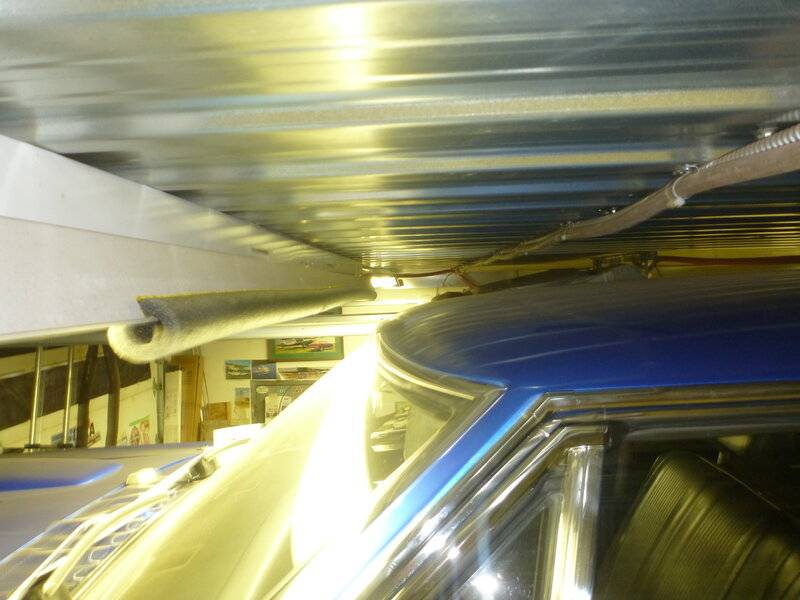

Fits nicely between my overhead florescent and incandescent lights.

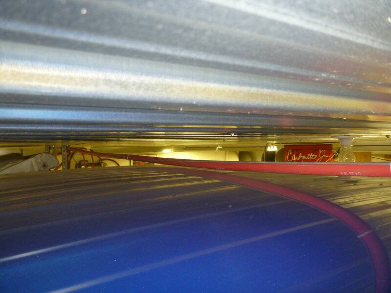

3" of clearance and my air line is a good "I'm there" indicator.
Why the Bee is backed in... to clear my light AND so the garage door can come almost fully up without hitting the windshield.

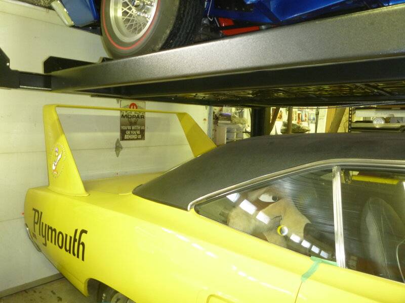

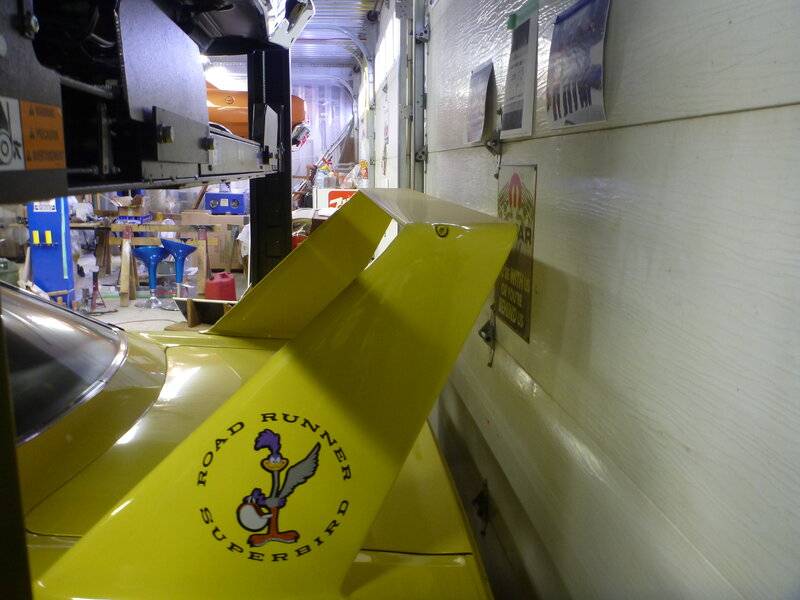

Bird wing will fit under the deck.

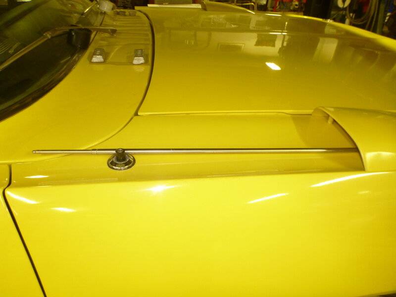

Remember the antenna is the highest point on our cars!

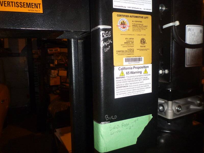

Positions marked and note the certified lift decal. A rarity in the "recreational" lift industry!
