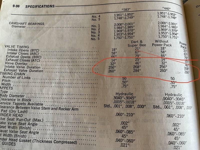

Speaking of the similarities of 383s & 440, found this recently.
I knew the 383 had a standard and higher performance version (magnum: bigger carb, intake, cam, & smaller combustion chamber heads)
I didn’t know the 440 did some of that too for ‘69 coronets & chargers
Just used the smaller cam though; at least that what my service manual implies.
Guess it would be non-magnum 440s?
