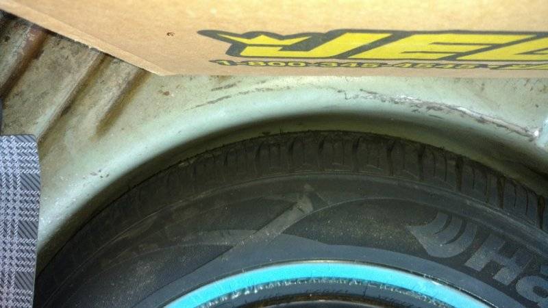

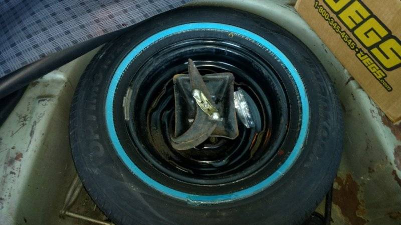

OK boys - here are some pics of my set up. It fits good in the well with the 205/75-14 and the overall diameter is very close to what's on the ground (245/60/14) and also the other consideration was to make sure the fiberboard cover would still sit flat in the trunk floor. Originally I tried to use a matching 14x7 wheel I had for the spare but it would not allow the board to sit flat.
