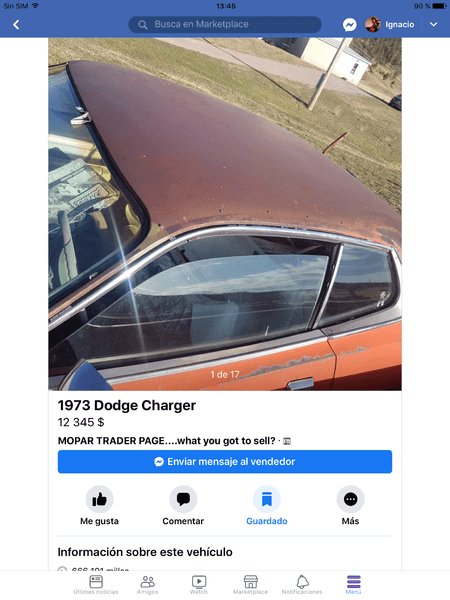

There is a 74 ( add says 73 but is 74 really ) being sold on facebook in 2K at Mopar Trade Page group with lot of good parts on it ( I'm drooling on some ) to be parted out. Roof is intact with just surface rust. Unfortunatelly located in SD
Very interesting it got brougham panels on Hardtop REALLY WEIRD. Is the second one I'm aware. The first one become on a panels donor for my car and it was in Canada.
