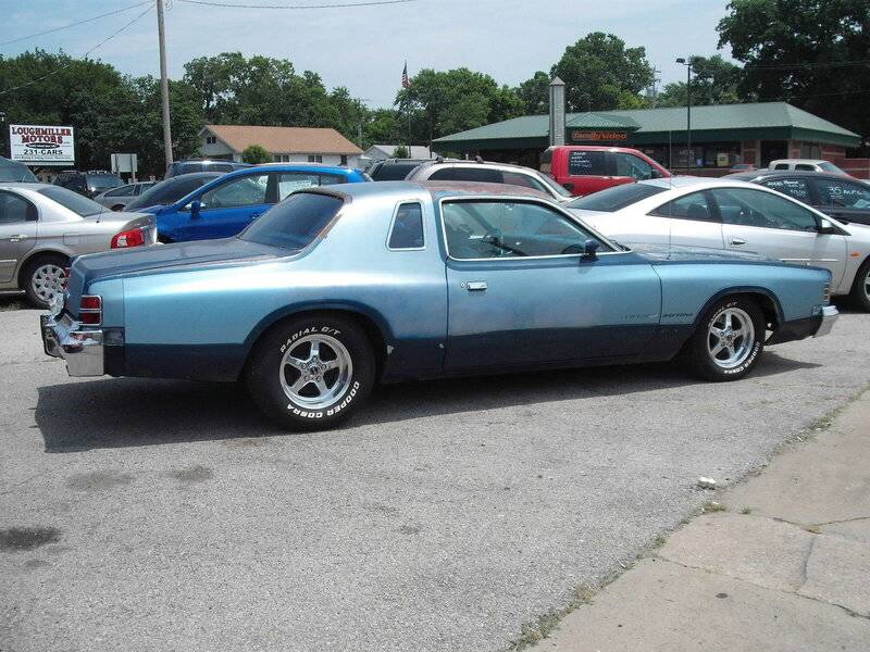

the rear glass is more vertical and sligtly curved, so the rear edge of roof skin should be diff too to acomodate the glass on the diff angle too.
To me it also looks like the side glass area is more horizontal on the 75-79.
That might be an optical illusion because the door top is more horizontal.

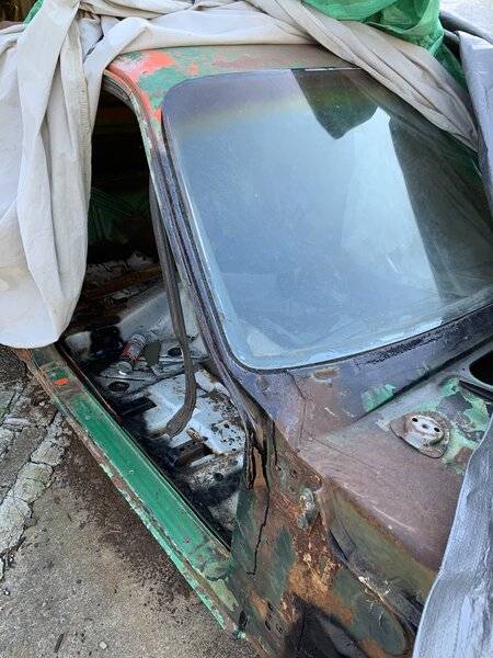

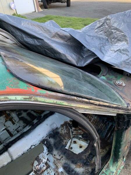

The windshield is taller on a 77 Córdoba versus a 71 rr. I just use it to plug the hole. Not sure if this helps. Good luck.
