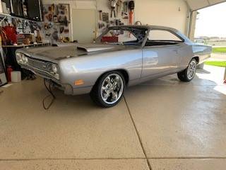

Sure it will. I ran 295/50-15's on a 15x10 with 5.5" BS for a few years on my '69 Sport Satellite. The passenger side would rub just a little bit in the top of the wheel well when I went over a big bump. Nothing that I couldn't live with. Probably put 5000 miles on the car with those wheels and tires.

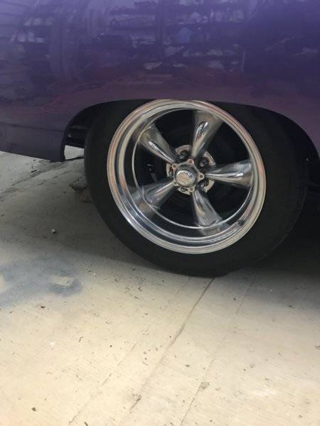

Here’s what’s on mine. Looks to be about 6” backspace

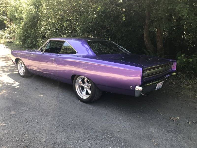

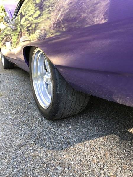

Yes, 305/40/18 10 inch, no sure of off set about 5 inches I think. No rubbing.
