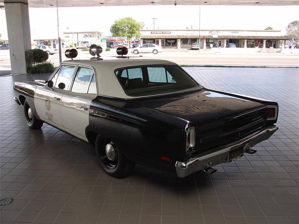

Are we talking about a 4 door plymouth here?
i'm lost as hell too.
2dr.....was told the previous owner tried multiple trunk lids and the 1 I got with the car was the only 1one that fit....hopefully I can get pics and measurements today....we were in Salina trying to get some racin in but weather didn't want to cooperate.....im from North Platte ne.
4 door trunk lid might be different if that's what he was trying? or, maybe he was trying the wrong year?
68, 69 and 70 are all different trunk lids, maybe not so much in length but the back of the trunk lids are different.
here's a 4 door plymouth, the back glass is different and the filler panel between trunk lid and back glass is different from a 2dr but I think the trunk lid might still be the same as a 2dr trunk lid... Not sure though.
trunk lid is the exact same animal on 2 and 4 dr 68-70 b bodys
