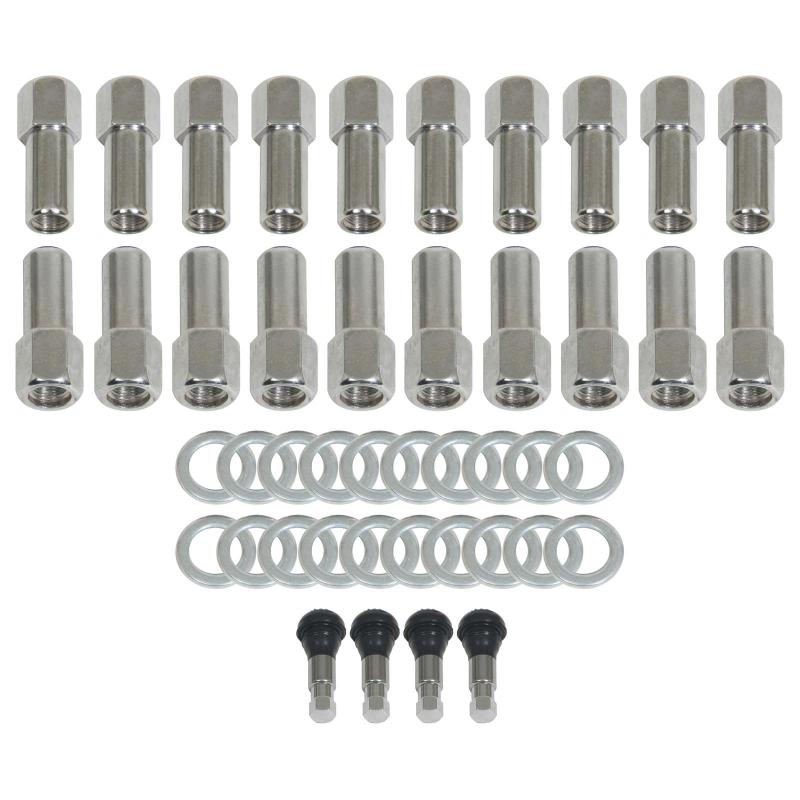

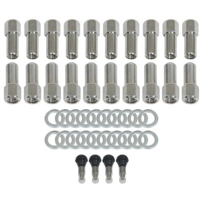

Are the standard Crager lug nuts NHRA legal? I see where the studs have to stick thru 1/2" or something like that. How do you make that work?
you have to use an open wheel lug nut/washer & longer studs, for 1/2 " studs like these from Summit Racing SST Mag SUM-7555012SST-O $27-$29 or something similar
  • Rim wheel lug nuts open ends NHRA aproved SST Mag $29.97 0.500 inch SUM-7555012SST-O_xl.jpg
