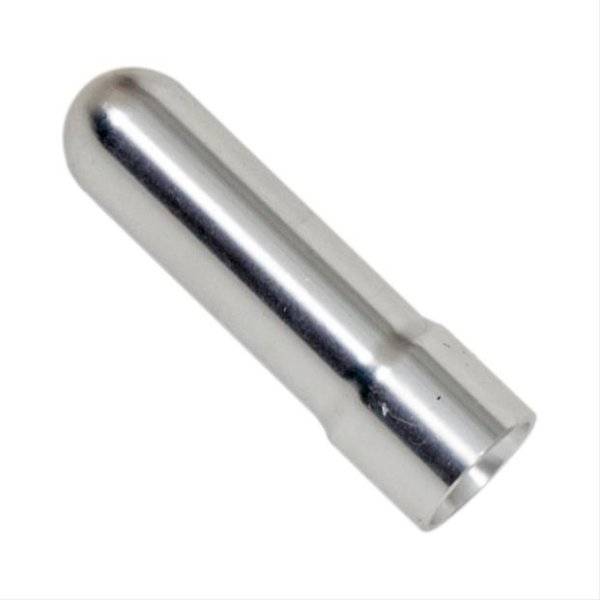

Hey Guys Was Installing My Wilwood Master Cylinder The Other Day On My Disc/Disc Setup With A Factory Tyle Booster and Adapter Plate..
When I Went To Bolt It Up The Master Cylinder Seemed To Not Wanna Tighten Down. The Adjustable Pushrod In The Booster Was Backed All The Way In..
How Do I Adjust It To Fit?
Cut Down The Aluminum Bullet Shaped Piece in The Master.
Not Sure How To Adjust The Depth?
Thanks
I think they come with a billet plunger ( spacer) that is in the bore for additional length. May need to remove it.

I Know That That Plunger Was Too Long And Put Pressure On The Rod Coming Out Of The Power Booster

Did you see my answer above?
Yes. Im Gonna Try Ans Remove It. But With It Removed Isnt That Quite a Bit Of Distance For The Plunger to Travel?
I did mine a while back and installed hydroboost. I just remember having the spacer and not needing it because of the way mine was set up.

i just talked to wilwood. they said to cut that aluminum spacer to correct length. Makes since i guess , but would be nice if they mentioned that in the instructions somewhere. my push rod is adjustable so i have some wiggle room.
hope this info helps you finish it up!
