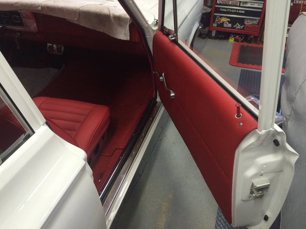

Going to install the Windlacing/ weatherstrip in my 65 Bell II. It has been far too long since I have done this on my R/T. So can you tell me, should I be using some dabs of weatherstrip adhesive here and there to affix it more securely, or just slide the channel over the pinch welds and be done with it? Also the under roof rail channel window seal. I think that particular run does require some cement. Just want to be sure. Thank you in advance for any and all suggestions/help.

The windlace should grab on without adhesive. But, if it's loose or something it won't hurt to put a little on the pinch weld before installing. I would try it dry first.
Every windlace ive ever dealt with had a metal spine that a litte squeeze would help tighten things up..also a small deadblow helps get things formed around radi, corners ect
The wind lace is fairly snug so I found no adhesive needed. Start at the bottom middle of the door and work your way around. The small dead blow helps as mentioned above. Take your time at the top with the head liner. Don't cut the wind lace until everything is exactly as you want it.
You may need to massage the pinch weld to get the wind lace to sit correctly and have the doors close easily. The pinch weld can be moved or bent in or out, and some grind the pinch weld to get the wind lace to site just right.
My doors were really snug and had to be slammed when the wind lace was first installed, but they are getting easier to close now after some use.
